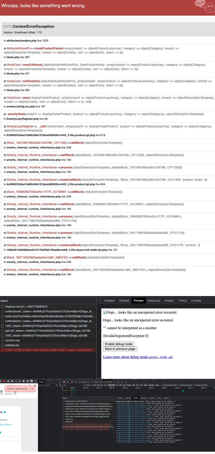

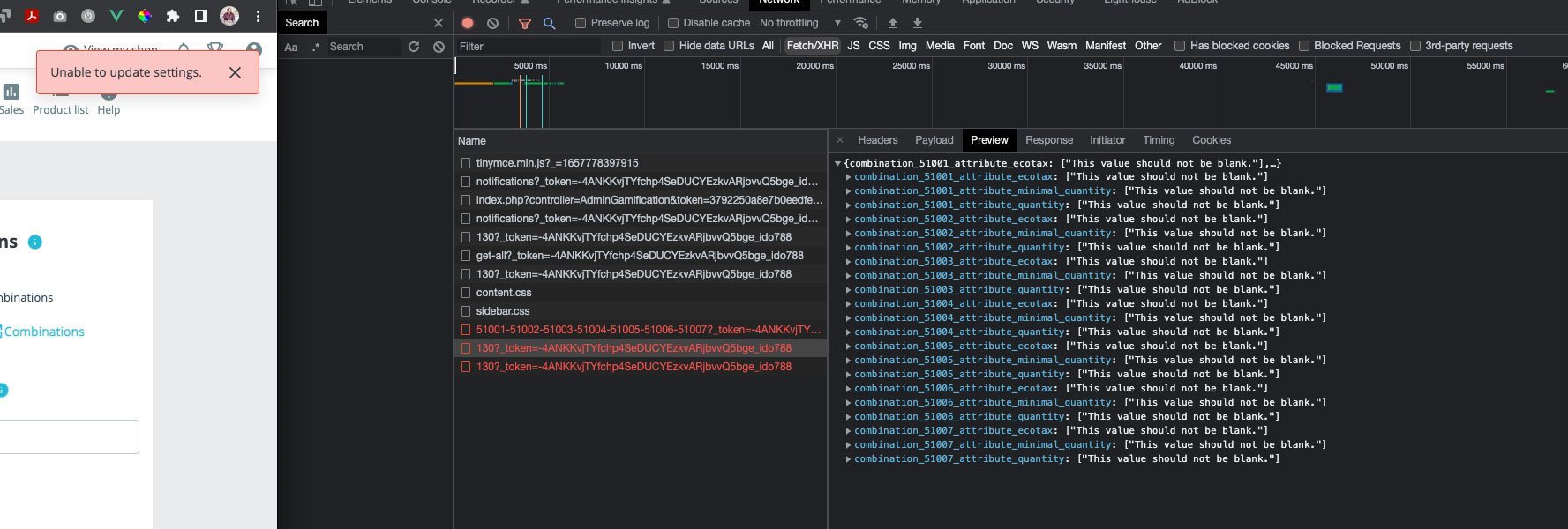

andtrx Posted July 13, 2022 Author Share Posted July 13, 2022 (edited) @Daresh Seeing as you might have worked with the module in the past I will dare ask. I finally have everything installed regarding the module but I have 2 problems: 1. When I have the debug mode set to ON, the following happens: -> I create separate combinations for 1 product -> Iif I visit product page and I get the following error, please see first part of the attached image -> When this mode is ON I can update the product 2. When I have debug mode set to OFF -> I cannot update the prodcut anymore -> I get errors in the requests (please see last part of the image, the errors in dev tools part) -> I can visit the product page Any idea what might cause this behavior? Edited July 14, 2022 by andtrx Extra information (see edit history) Link to comment Share on other sites More sharing options...
