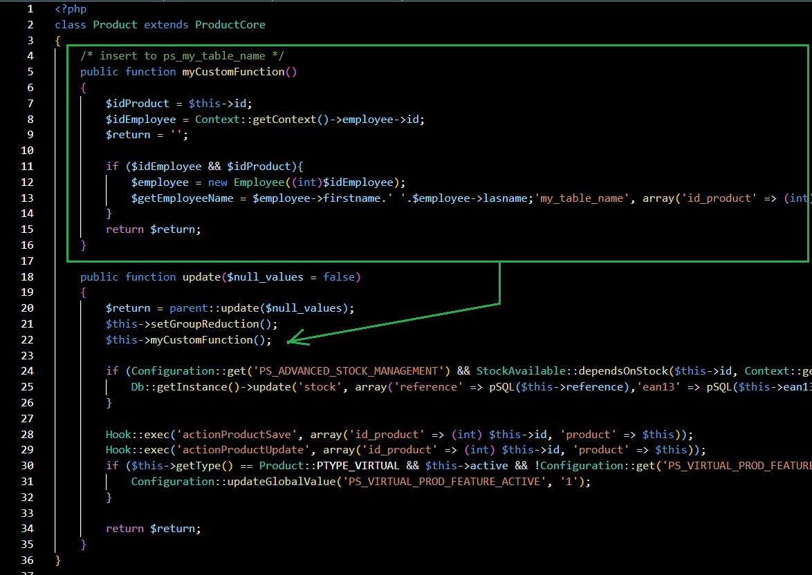

knacky Posted July 8, 2022 Share Posted July 8, 2022 ????? Now I don't understand the question ????? Link to comment Share on other sites More sharing options...
knacky Posted July 8, 2022 Share Posted July 8, 2022 File ./override/classes/Product.php Link to comment Share on other sites More sharing options...
Luigi Donato Posted July 9, 2022 Author Share Posted July 9, 2022 21 hours ago, knacky said: File ./override/classes/Product.php I mean that the update function must be copied before adding custom lines. I can't just tell PrestaShop, run this code at the end or at the beginning, without first copying the entire code.. And if the code changes during an update, I'll have to manually intervene. Link to comment Share on other sites More sharing options...
