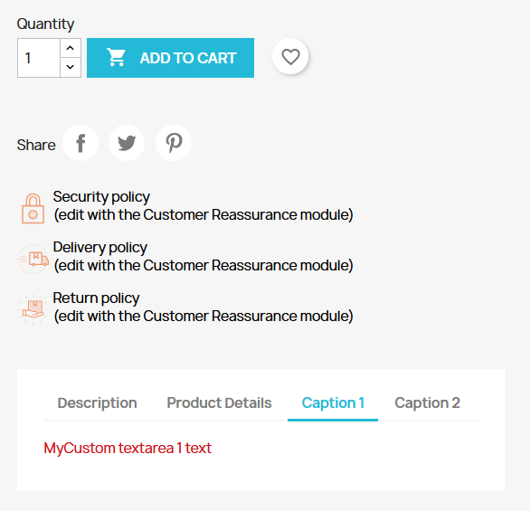

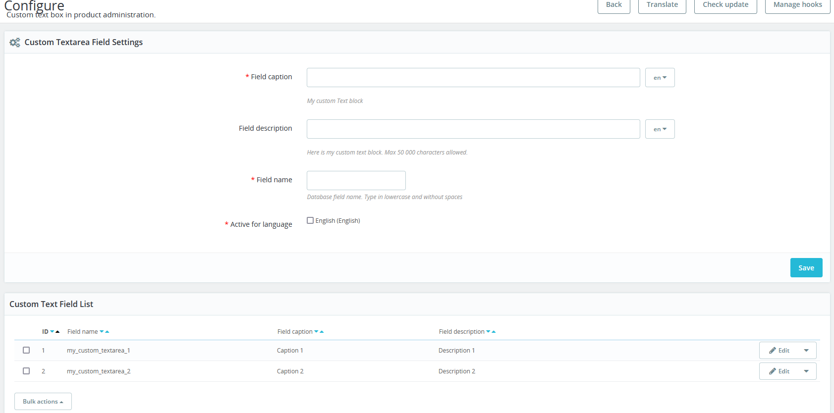

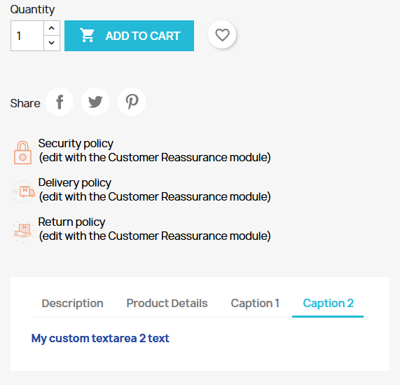

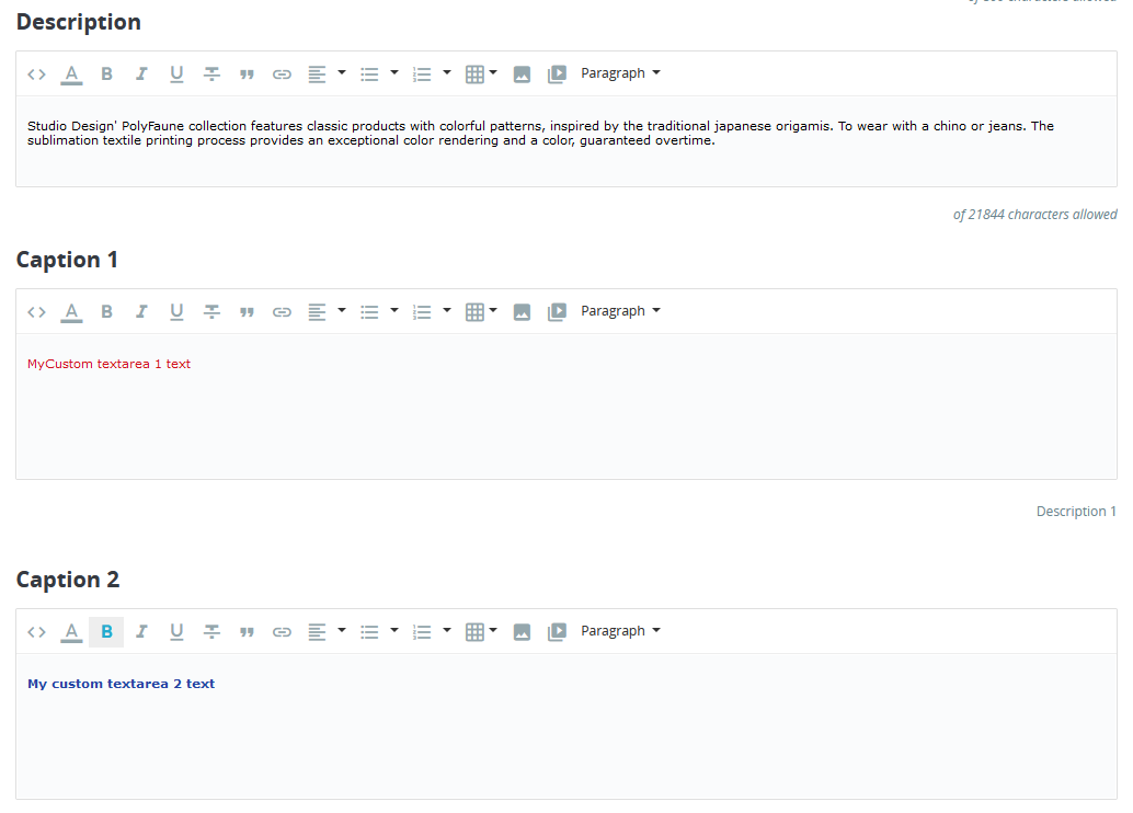

knacky Posted June 20, 2022 Share Posted June 20, 2022 No TWIG adjustment required. 30 minutes of work (PS 1.7.8.5) 😉 It's done exactly as instructed, to which I sent you a link. Custom module: Hook: Product page: Link to comment Share on other sites More sharing options...
jmauclair Posted July 22, 2022 Author Share Posted July 22, 2022 On 6/20/2022 at 3:57 PM, knacky said: No TWIG adjustment required. 30 minutes of work (PS 1.7.8.5) 😉 It's done exactly as instructed, to which I sent you a link. Custom module: Hook: Product page: I'm digging out this topic because seems to worked perfectly and then I found out that when I click on save on my product page, the content in my custom tinymce textarea is not save, it only work when I click times on save. I've tried this : $(document).on('submit','form',function(){ console.log("send") var textAreas = document.querySelectorAll('textarea[name^=cust_]') textAreas.forEach(function(element){ console.log(element.attr('name')); window.parent.tinymce.triggerSave(); }) }) But it only works when the page is not fully loaded, when it's fully loaded, nothing How did you fix this issue ? Did find a way to set triggerSave with an other event or you didn't have to do it ? Link to comment Share on other sites More sharing options...
