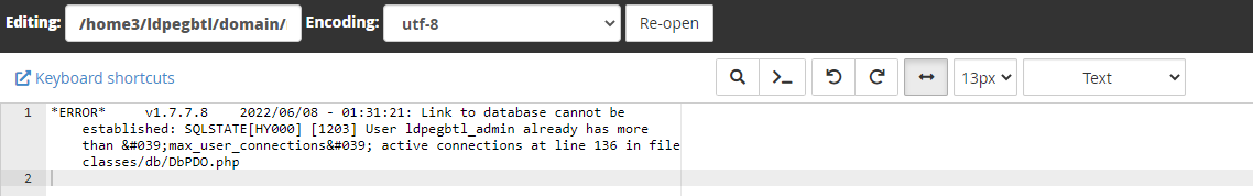

My Eco Mart Posted June 8, 2022 Share Posted June 8, 2022 Suddenly my Prestashop back office admin URL it not working, however the front office is working fine, and customer is able to place an order. I check the Log file under var directory and got the below error. *ERROR* v1.7.7.8 2022/06/08 - 01:31:21: Link to database cannot be established: SQLSTATE[HY000] [1203] User ldpegbtl_admin already has more than 'max_user_connections' active connections at line 136 in file classes/db/DbPDO.php Workaround I did Restored recent backup for both files and DB and No luck. Cleared all the cache directory in cPanel and No luck Restored all the backup files to an other site- No Luck Could anyone help me. Link to comment Share on other sites More sharing options...
