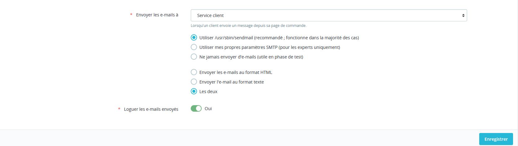

ZiedDams Posted June 7, 2022 Author Share Posted June 7, 2022 Just now, idnovate.com said: This error is not related with this problem. Which is your configuration for sending emails? Hello @idnovate.com thank you for your time this is my configuration i kinda have a weird problem when i try to send an email to [email protected] it doesn't work but if i try a custom domain like [email protected] it work . any hints form you will help, thank you again Link to comment Share on other sites More sharing options...
