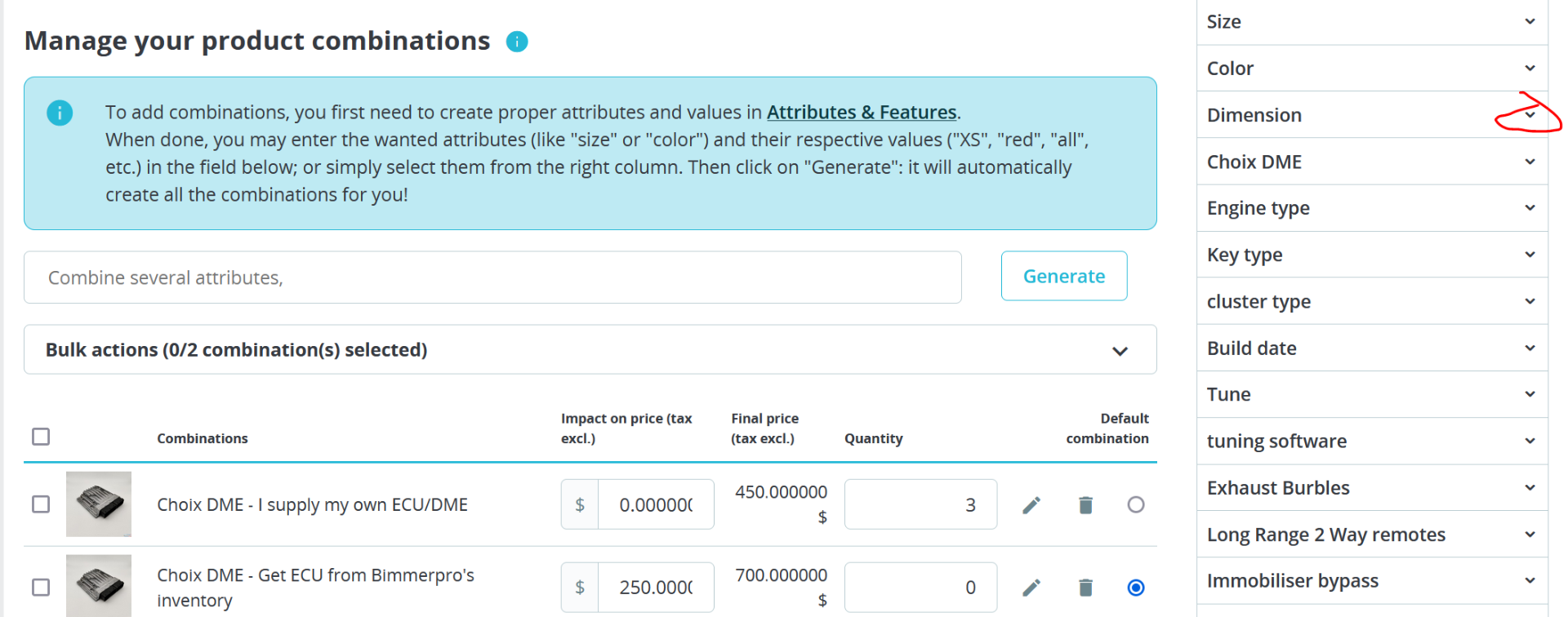

Marc_qc Posted June 5, 2022 Share Posted June 5, 2022 Hi, I am having a problem in my prestashop backend since I upgraded to 1.7.8.5. In the backend I go to: Catalog --> Product then I select a product to work on its combinations I then select the combination tab. At this point, I would like to specify size, color or Dimension, but when I click these options, the accordion menu opens and closes immediately preventing me from clicking any option. It was functional before I upgraded to release 1.7.8.5. the store is on a shared server with PHP 7.3, and I am using the default theme from prestashop. I wonder if my problem is related to my specific configuration or something related to ver 1.7.8.5 Can anyone validate that this behaviour can be reproduced???? Thanks I included a screen shot for better clarity Link to comment Share on other sites More sharing options...

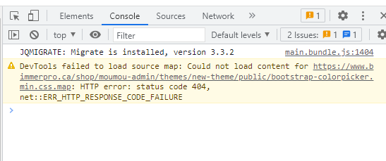

Prestachamps Posted June 6, 2022 Share Posted June 6, 2022 Hello, Open the browser developer tool, press F12, and then select consoles from the list of tabs. If there is an error, javascript can perform this problem. Have a nice day. Kind regards, Leo Link to comment Share on other sites More sharing options...
Marc_qc Posted June 6, 2022 Author Share Posted June 6, 2022 HI, thanks for guiding my onto investigating this behavior I am experiencing. I followed your instruction and as you were expecting, the console reports an error: Error status code 404 ERR_HTTP_RESPONSE_CODE_FAILURE see screen shot below. I am not sure where do I go from here... Marc L Link to comment Share on other sites More sharing options...
Marc_qc Posted June 6, 2022 Author Share Posted June 6, 2022 Investigating further the problem, the page is refering to the following site mysite.com/themes/new-theme/public/bootstrap-colorpicker.min.css.map and this file doesn't exist on the server. I finally found the same problem reported back in february in the french section of the forum Here is the link I hope someone can help us find how to resolve this issue.... Thanks Link to comment Share on other sites More sharing options...

Prestachamps Posted June 15, 2022 Share Posted June 15, 2022 Hi, the warning related to .css.map file should not cause this issue. I suspect that you have activated or installed some product related module which can prevent in some cases the functionality of the attributes dropdown. Is the Bulk actions dropdown working, or that one has also issue on this BO product edit page? You can also try to create a new Backoffice employee with superadmin permissions and check with that employee if the issue is stil present for that one too. Have a nice day, Leo. Link to comment Share on other sites More sharing options...
