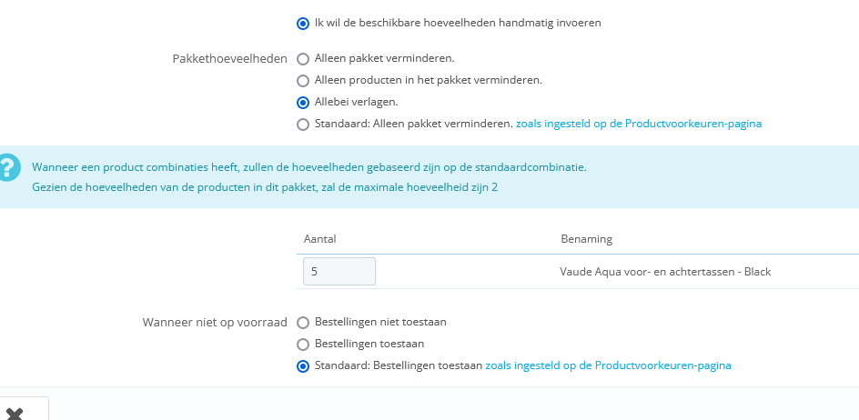

Hi,
What is going wrong here?
I have a pack of products, in the backend the stock for the complete pack is 5.
In the frontend it says out of stock: https://www.bike4travel.nl/achtertassen/5771-vaude-aqua-voor-en-achtertassen-black.html
I have cleaned the cache.
I have another pack of products, same settings and stock information both backend and front-end are correct!
I cannot find the culprit of this issue, anybody knows where to look and how to correct this?
Prestashop 1.6.1.24
If you need more info, please let me know.
Thanks for your help, Ellen
Screenshot 2022-06-01 at 11-55-19 Producten Bewerk Vaude Aqua voor- en achtertassen - Black • Bike4Travel.png

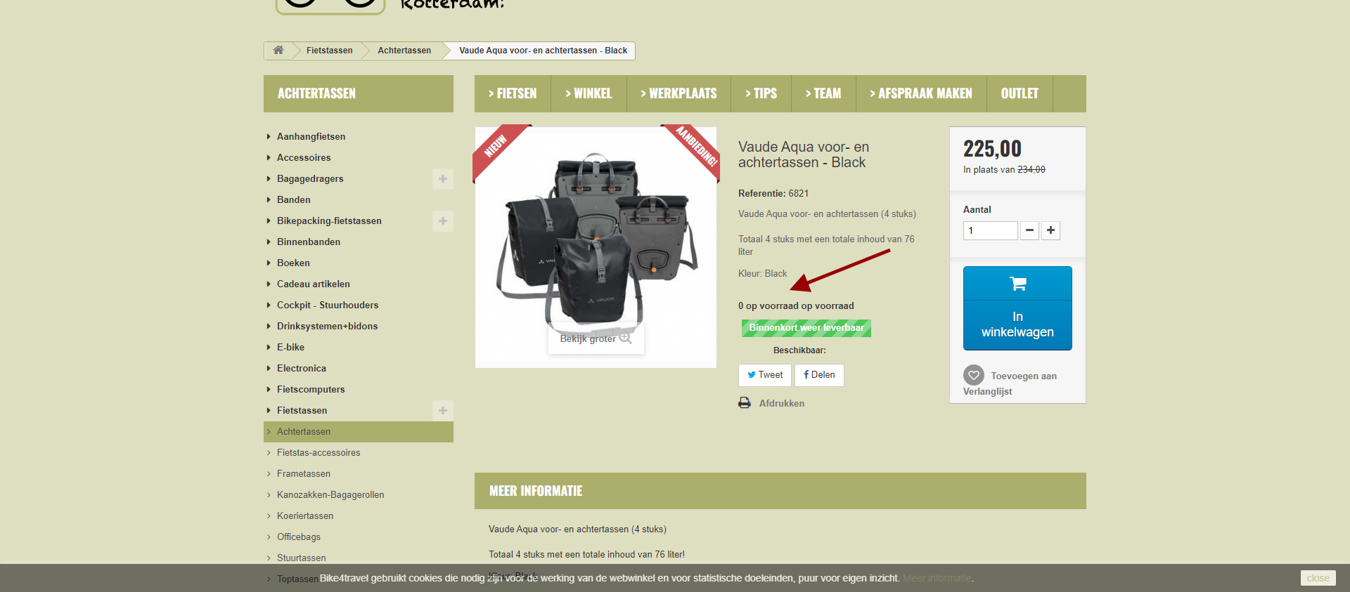

Hi Ellen,
As you're using Ps 1.6 the stock available variable is inside the source, and when I checked it (it shows 0) ( see screenshot)
As I can't see the data in the DB, what I would do is resave the pack product.
I've tested if the pack products one by one, are on stock, and indeed one product has 5 pieces (the other one 7) - which means that the pack maximum quantity is 5 as stated.

What do you mean by 'resave'? Because I have changed and saved the pack multiple times.
