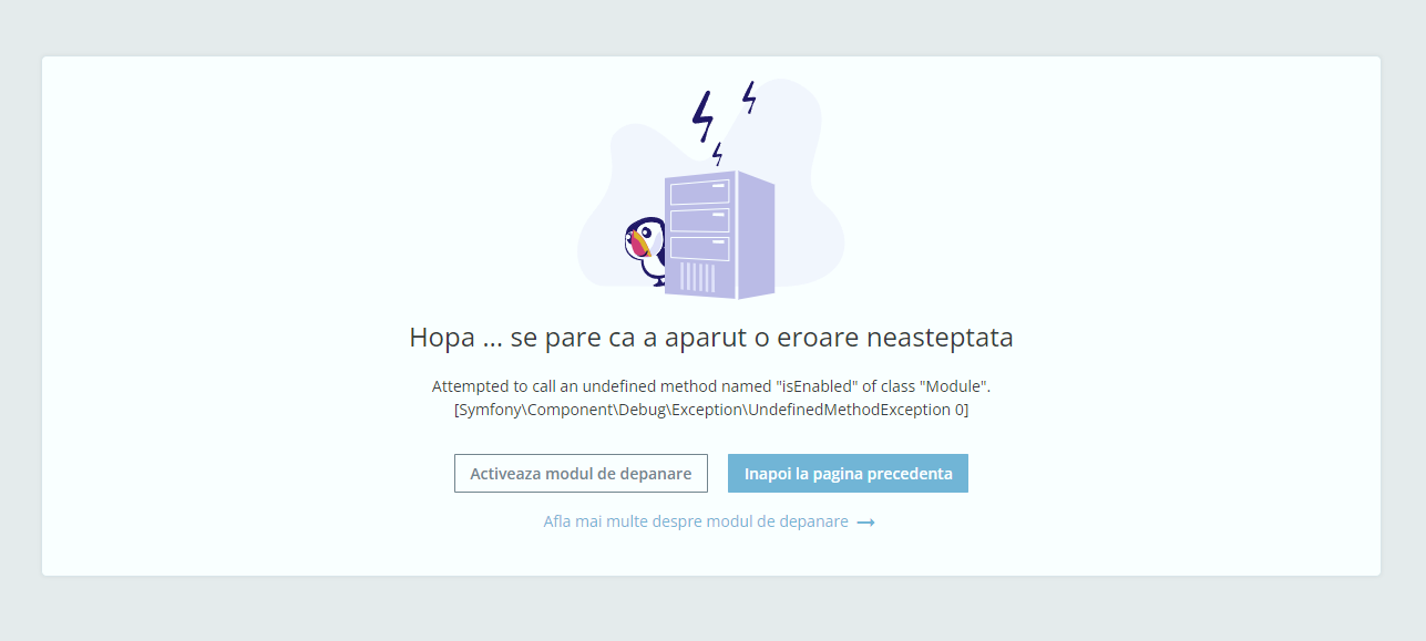

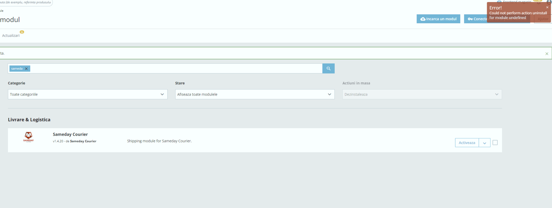

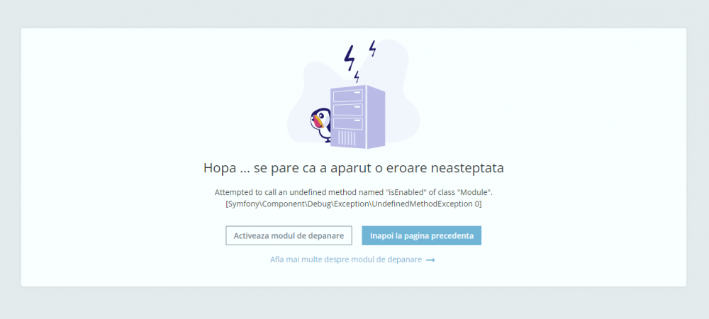

The problem appears when trying to clear the cache, uninstall modules, or reset them.
After trying to do any of the tasks above, I get this error:
Attempted to call an undefined method named "isEnabled" of class "Module". [Symfony\Component\Debug\Exception\UndefinedMethodException 0]
As seen in the screenshots below, when trying to activate debug mode I get HTTP ERROR 500. This is when the website becomes unreachable by any means, front office and back office.

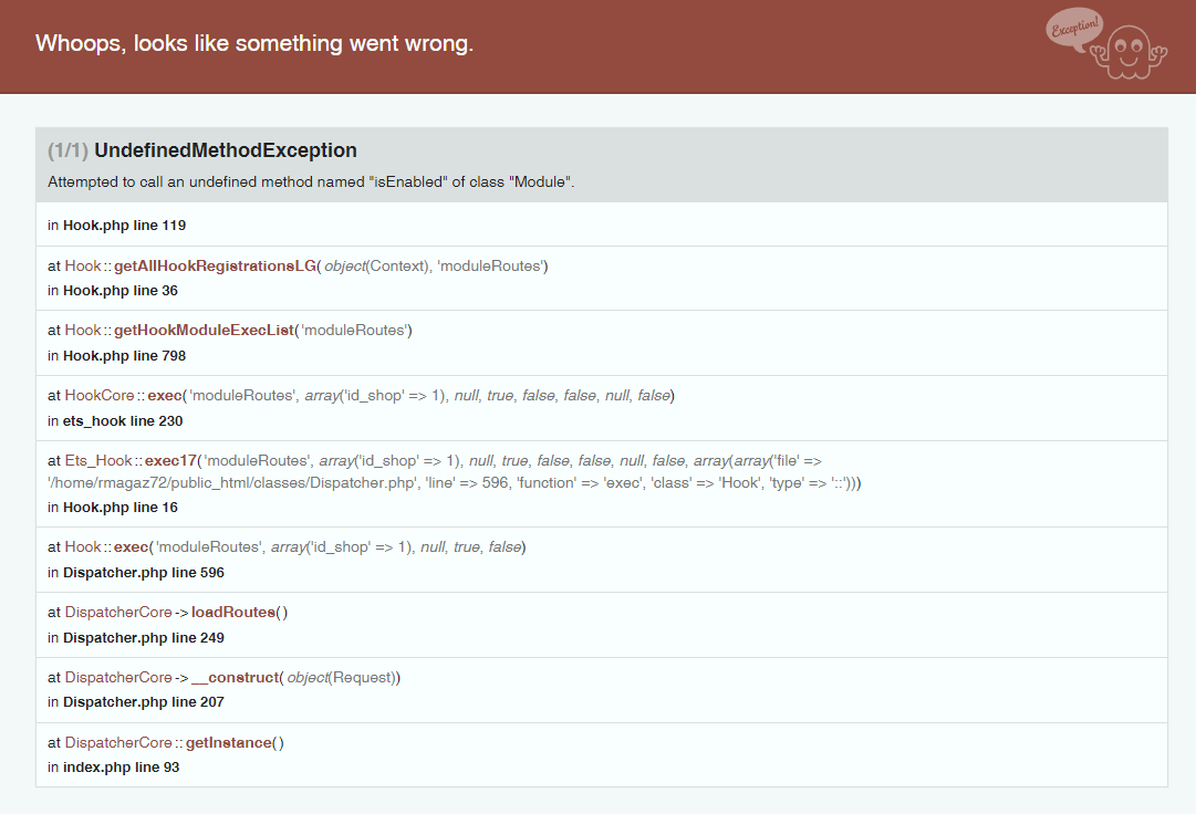

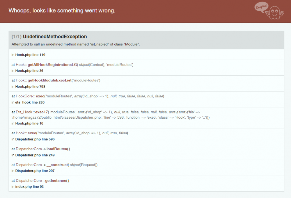

After deleting cache from server, when accessing administration URL we get this error code:
Whoops, looks like something went wrong.
(1/1) UndefinedMethodException
in Hook.php line 119
at Hook::getAllHookRegistrationsLG(object(Context), 'moduleRoutes')in Hook.php line 36
at Hook::getHookModuleExecList('moduleRoutes')in Hook.php line 798
at HookCore::exec('moduleRoutes', array('id_shop' => 1), null, true, false, false, null, false)in ets_hook line 230
at Ets_Hook::exec17('moduleRoutes', array('id_shop' => 1), null, true, false, false, null, false, array(array('file' => '/home/rmagaz72/public_html/classes/Dispatcher.php', 'line' => 596, 'function' => 'exec', 'class' => 'Hook', 'type' => '::')))in Hook.php line 16
at Hook::exec('moduleRoutes', array('id_shop' => 1), null, true, false)in Dispatcher.php line 596
at DispatcherCore->loadRoutes()in Dispatcher.php line 249
at DispatcherCore->__construct(object(Request))in Dispatcher.php line 207
at DispatcherCore::getInstance()in index.php line 93

You are running an outdated version from PrestaShop together with a non-compatible PHP version:
https://devdocs.prestashop.com/1.7/basics/installation/system-requirements/#php-compatibility-chart
My advice would be to update PS to the latest version.
And the error is thrown by an override from the cookies module. I think you can rename /override/classes/Hook.php meanwhile.
