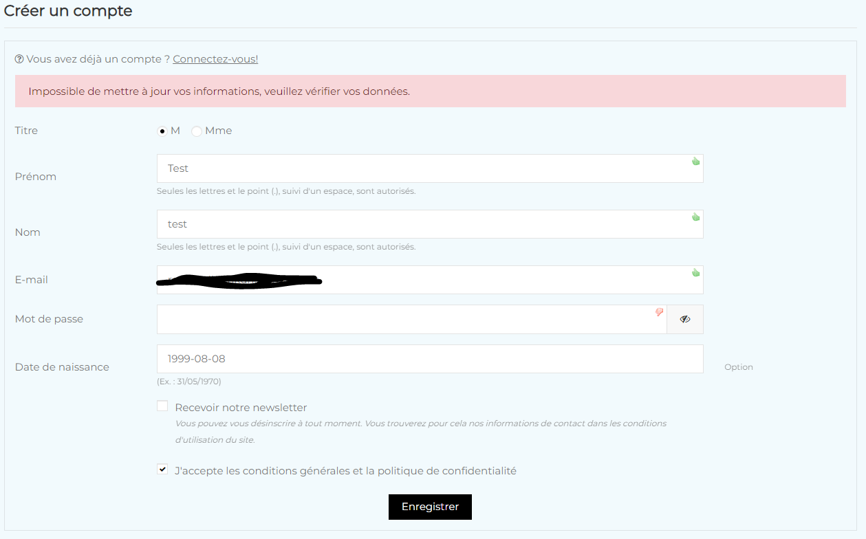

Hey I have an issue on my web site https://www.appetit-clic.fr/nateciaself/connexion?create_account=1
Custumer can not create an account and i don't why tbh.
My ps is in 1.7.8.3 and i use warehouse theme in 4.5.2.
My php version is 7.3 and my site is on OVH.
Maybe someone have a similar issue ?
I can create client account in back office but they cant in front with the inscription form.
It was working well thursday night and then friday morning the issue came. I did not do anything during this time...
Thx

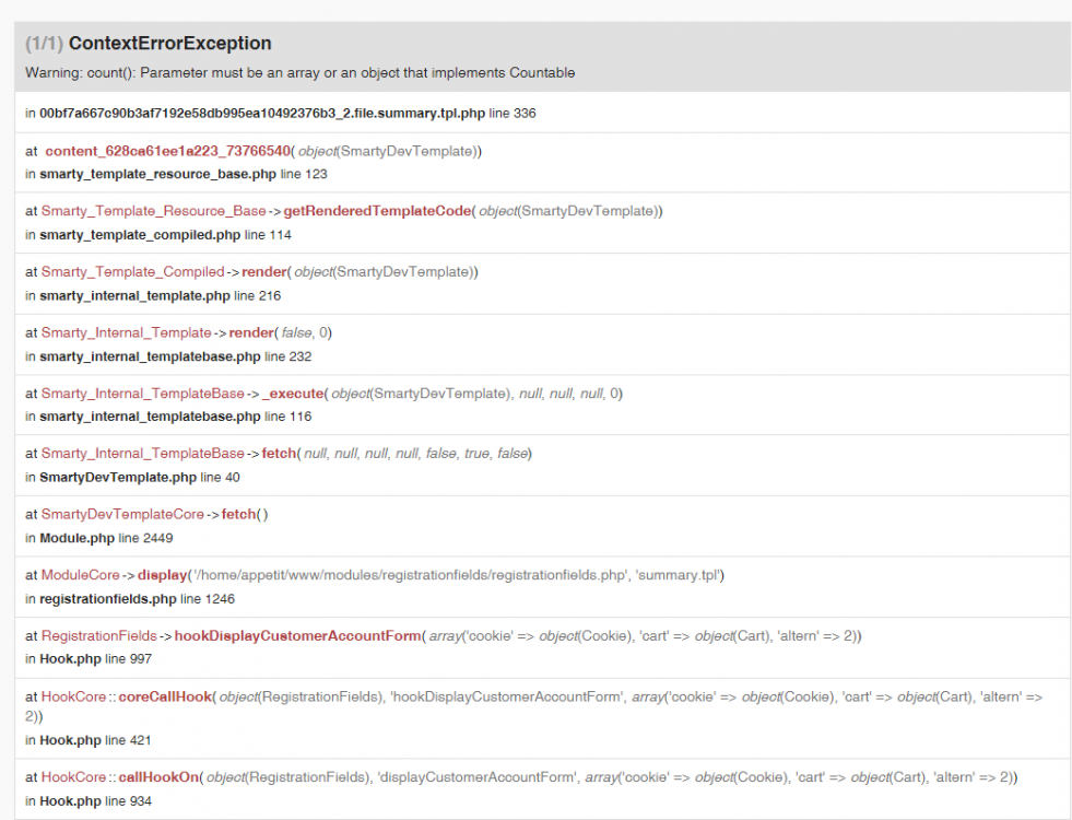

Hi,
Please turn on debug mode to see the error.
I suspect the issue is due to these tabs "Vous souffrez d'une allergie ou d'une autre pathologie ? Veuillez impérativement nous contacter au 04.72.37.43.77 afin que nous vous aidions à composer un repas qui vous est adapté."
If its via a module please disable it and then check.
Regards
2 minutes ago, Mian Waqas said:
Hi,
Regards
Hello thanks a lot for your answers. Indeed its a module that let me add more field in the inscription form. But i use it for a long time now and always worked well, idk if module can auto update themself ?
im going to check debug and i will come back to you.
ty
