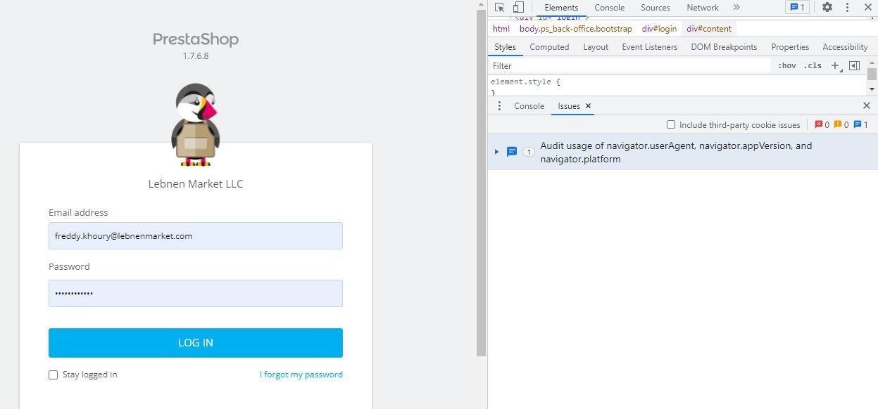

Freddykhoury Posted May 17, 2022 Share Posted May 17, 2022 Hello, I have copied the online version to my localhost and i cannot login to my backend the website open on my localhost but not the backend After clickingon login the page loads again and there is no error. debug is true PHP version is 7.3.3 same as the online server I also tried it on chrome, firefox, IE I have attached an image thank you Link to comment Share on other sites More sharing options...

Freddykhoury Posted May 18, 2022 Author Share Posted May 18, 2022 Thank you guys for the quick reply but unfortunatly non of the solution worked I deleted the cache folder, renamed the folder and still the same issue I have changed the domain name and the frontend is working fine I already installed the latest prestashop on my localhost all is working fine below is the htaccess file content Hope it can help fine the error # ~~start~~ Do not remove this comment, Prestashop will keep automatically the code outside this comment when .htaccess will be generated again # .htaccess automaticaly generated by PrestaShop e-commerce open-source solution # https://www.prestashop.com - https://www.prestashop.com/forums <IfModule mod_rewrite.c> <IfModule mod_env.c> SetEnv HTTP_MOD_REWRITE On </IfModule> RewriteEngine on #Domain: localhost RewriteRule . - [E=REWRITEBASE:/lm/] RewriteRule ^api(?:/(.*))?$ %{ENV:REWRITEBASE}webservice/dispatcher.php?url=$1 [QSA,L] # Images RewriteCond %{HTTP_HOST} ^localhost$ RewriteRule ^([0-9])(\-[_a-zA-Z0-9-]*)?(-[0-9]+)?/.+\.jpg$ %{ENV:REWRITEBASE}img/p/$1/$1$2$3.jpg [L] RewriteCond %{HTTP_HOST} ^localhost$ RewriteRule ^([0-9])([0-9])(\-[_a-zA-Z0-9-]*)?(-[0-9]+)?/.+\.jpg$ %{ENV:REWRITEBASE}img/p/$1/$2/$1$2$3$4.jpg [L] RewriteCond %{HTTP_HOST} ^localhost$ RewriteRule ^([0-9])([0-9])([0-9])(\-[_a-zA-Z0-9-]*)?(-[0-9]+)?/.+\.jpg$ %{ENV:REWRITEBASE}img/p/$1/$2/$3/$1$2$3$4$5.jpg [L] RewriteCond %{HTTP_HOST} ^localhost$ RewriteRule ^([0-9])([0-9])([0-9])([0-9])(\-[_a-zA-Z0-9-]*)?(-[0-9]+)?/.+\.jpg$ %{ENV:REWRITEBASE}img/p/$1/$2/$3/$4/$1$2$3$4$5$6.jpg [L] RewriteCond %{HTTP_HOST} ^localhost$ RewriteRule ^([0-9])([0-9])([0-9])([0-9])([0-9])(\-[_a-zA-Z0-9-]*)?(-[0-9]+)?/.+\.jpg$ %{ENV:REWRITEBASE}img/p/$1/$2/$3/$4/$5/$1$2$3$4$5$6$7.jpg [L] RewriteCond %{HTTP_HOST} ^localhost$ RewriteRule ^([0-9])([0-9])([0-9])([0-9])([0-9])([0-9])(\-[_a-zA-Z0-9-]*)?(-[0-9]+)?/.+\.jpg$ %{ENV:REWRITEBASE}img/p/$1/$2/$3/$4/$5/$6/$1$2$3$4$5$6$7$8.jpg [L] RewriteCond %{HTTP_HOST} ^localhost$ RewriteRule ^([0-9])([0-9])([0-9])([0-9])([0-9])([0-9])([0-9])(\-[_a-zA-Z0-9-]*)?(-[0-9]+)?/.+\.jpg$ %{ENV:REWRITEBASE}img/p/$1/$2/$3/$4/$5/$6/$7/$1$2$3$4$5$6$7$8$9.jpg [L] RewriteCond %{HTTP_HOST} ^localhost$ RewriteRule ^c/([0-9]+)(\-[\.*_a-zA-Z0-9-]*)(-[0-9]+)?/.+\.jpg$ %{ENV:REWRITEBASE}img/c/$1$2$3.jpg [L] RewriteCond %{HTTP_HOST} ^localhost$ RewriteRule ^c/([a-zA-Z_-]+)(-[0-9]+)?/.+\.jpg$ %{ENV:REWRITEBASE}img/c/$1$2.jpg [L] # AlphaImageLoader for IE and fancybox RewriteRule ^images_ie/?([^/]+)\.(jpe?g|png|gif)$ js/jquery/plugins/fancybox/images/$1.$2 [L] # Dispatcher RewriteCond %{REQUEST_FILENAME} -s [OR] RewriteCond %{REQUEST_FILENAME} -l [OR] RewriteCond %{REQUEST_FILENAME} -d RewriteRule ^.*$ - [NC,L] RewriteRule ^.*$ %{ENV:REWRITEBASE}index.php [NC,L] </IfModule> AddType application/vnd.ms-fontobject .eot AddType font/ttf .ttf AddType font/otf .otf AddType application/font-woff .woff AddType font/woff2 .woff2 <IfModule mod_headers.c> <FilesMatch "\.(ttf|ttc|otf|eot|woff|woff2|svg)$"> Header set Access-Control-Allow-Origin "*" </FilesMatch> <FilesMatch "\.pdf$"> Header set Content-Disposition "Attachment" Header set X-Content-Type-Options "nosniff" </FilesMatch> </IfModule> <Files composer.lock> # Apache 2.2 <IfModule !mod_authz_core.c> Order deny,allow Deny from all </IfModule> # Apache 2.4 <IfModule mod_authz_core.c> Require all denied </IfModule> </Files> #If rewrite mod isn't enabled ErrorDocument 404 /index.php?controller=404 # ~~end~~ Do not remove this comment, Prestashop will keep automatically the code outside this comment when .htaccess will be generated again Link to comment Share on other sites More sharing options...
Freddykhoury Posted May 18, 2022 Author Share Posted May 18, 2022 May this can help I am also not able to login as user from the frontend when I enter a wrong password it tell me Authentication failed. but when i enter the correct password the page loads and nothing happens I tried to give full access to all folder and files but still Link to comment Share on other sites More sharing options...
