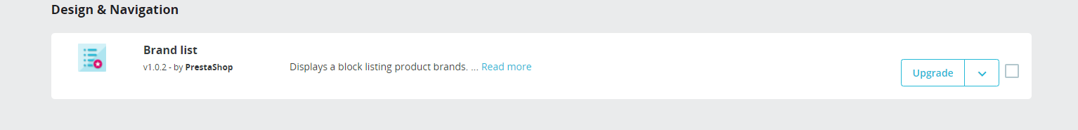

aRii Posted May 17, 2022 Share Posted May 17, 2022 Hi, hope you are well to whom is reading. I'm trying to increase the number of elements of brands in the block that is on the main menu I checked the tpl files but could not find anywhere mentioned where it gets this set number of 5 items instead of 10 . Thanks in advance Link to comment Share on other sites More sharing options...
Prestachamps Posted May 17, 2022 Share Posted May 17, 2022 Hi, if this is part of the menu, then most probably you are using a third party menu, where this widget should have some configuration. In the case it has no configuration then most probably this limitation is hardcoded into the module. What is the name of the menu module you are using? Kind regards, Leo. Link to comment Share on other sites More sharing options...
aRii Posted May 17, 2022 Author Share Posted May 17, 2022 11 minutes ago, Prestachamps said: Hi, if this is part of the menu, then most probably you are using a third party menu, where this widget should have some configuration. In the case it has no configuration then most probably this limitation is hardcoded into the module. What is the name of the menu module you are using? Kind regards, Leo. Its called brand list , its the default one. Thanks for your reply! Link to comment Share on other sites More sharing options...
Prestachamps Posted May 18, 2022 Share Posted May 18, 2022 HI, if you configure that module(Dropdown at Upgrade -> Configuration), in the configuration options there is a limit "Number of elements to display" , increase that to more than 5 to be shown more than 5 items. Kind regards, Leo Link to comment Share on other sites More sharing options...
