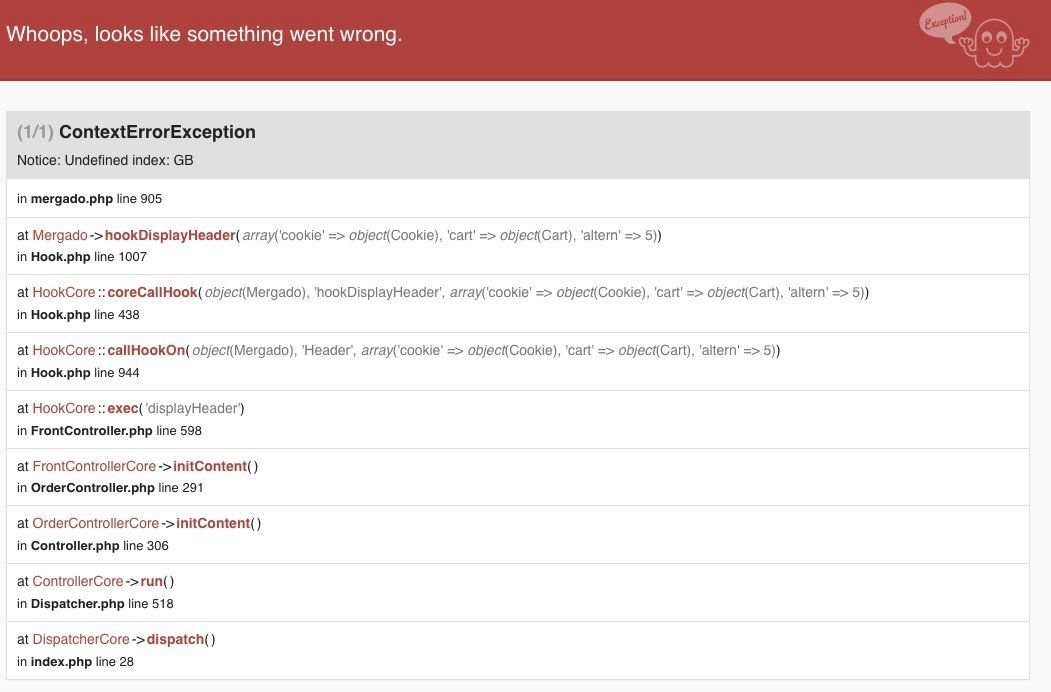

sp3ctre Posted May 13, 2022 Share Posted May 13, 2022 (edited) I have had a problem with the Stripe module and when I tested it in debug mode I get the following on the order checkout page. I have made sure all modules are up to date. Previously I also got an error trying to enable debug mode and I had to set session.save_path to /tmp to get past that. Now I can't take any payments on my shop other than bank transfer. Any help would be appreciated. UPDATE: I have removed the mergado module and now I am getting "Unfortunately, there is no payment method available.". This is despite Stripe and Bank Transfer both being enabled. I have tried re-installing them and still not working. All options are enabled in the payment settings (all locations have striper and bank trand ticked, as well as the GBP currency) Edited May 13, 2022 by sp3ctre (see edit history) Link to comment Share on other sites More sharing options...

sp3ctre Posted May 13, 2022 Author Share Posted May 13, 2022 Hi, that is already enabled... I have disabled the mergado modukle now and the site is back, but there are no payment options... wonder if the GB index thing is a clue though? Link to comment Share on other sites More sharing options...
Mian Waqas Posted May 13, 2022 Share Posted May 13, 2022 (edited) 30 minutes ago, sp3ctre said: Hi, that is already enabled... I have disabled the mergado modukle now and the site is back, but there are no payment options... wonder if the GB index thing is a clue though? yes its the issue with the language file, if the error is not appearing while this module is disabled then you can contact the module dev to fix it. thanks Edited May 13, 2022 by Mian Waqas change (see edit history) Link to comment Share on other sites More sharing options...
