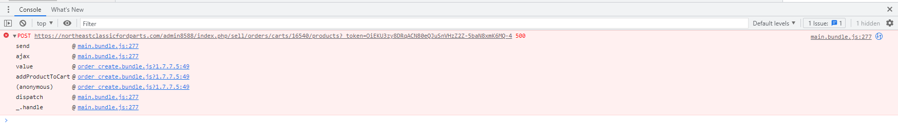

delconick Posted May 10, 2022 Share Posted May 10, 2022 (edited) Hello All, So I had a phone call just a few minutes ago and one of my customers is saying they received an error [Exception Code 0], I went into the back office to try to create a order for the customer and even tried making a order for my test customer and getting this same error, there is no other errors just says An unexpected error occurred. [Exception code 0] Could anyone point me in the right direction on fixing this, the last thing I was doing was adding suppliers to the back office. Edited May 10, 2022 by delconick (see edit history) Link to comment Share on other sites More sharing options...

delconick Posted May 10, 2022 Author Share Posted May 10, 2022 Here is the error: Link to comment Share on other sites More sharing options...
delconick Posted May 10, 2022 Author Share Posted May 10, 2022 (edited) Thanks to NickZ, got it working Edited May 10, 2022 by delconick (see edit history) 1 Link to comment Share on other sites More sharing options...
