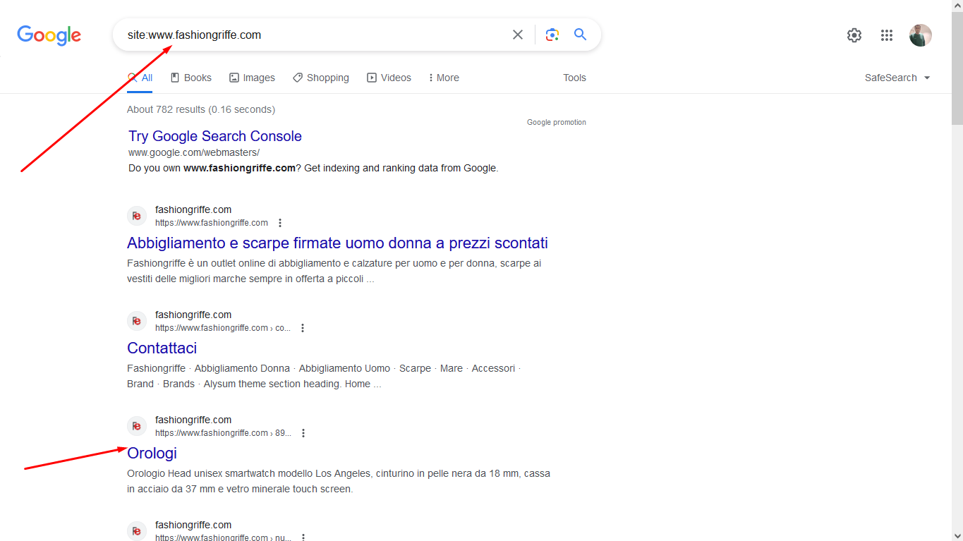

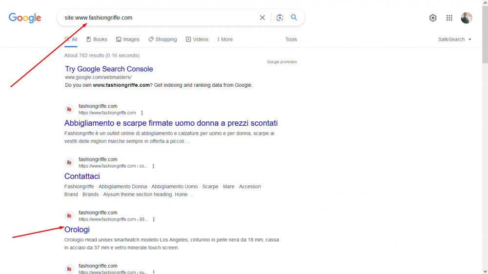

Zohaib-fk Posted November 6, 2023 Share Posted November 6, 2023 Hi Mitconsulting, You can find your website pages on Google search using keyword "site:www.fashiongriffe.com", attached is a screenshot for your reference, Also, you can use the inspection tool in the Google Search console. I have below 2 modules on the addons marketplace for fast indexing. The API services are from Google websites. [1]. Automatic Ping Services Integration https://addons.prestashop.com/en/seo-natural-search-engine-optimization/91680-automatic-ping-services-integration.html [2]. SEO Google Indexing API Integration https://addons.prestashop.com/en/seo-natural-search-engine-optimization/91461-seo-google-indexing-api.html Link to comment Share on other sites More sharing options...
