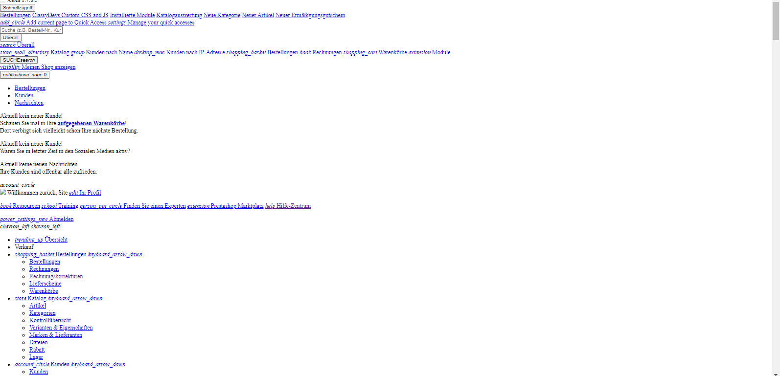

leadi Posted May 9, 2022 Share Posted May 9, 2022 hello I have a problem with my prestashop backend. I have just installed a new template, of which I only want to use the checkout. It is possible that I have also deactivated settings for the backend under "positions". Now only this page is displayed. If I click on a sub-item, I also get to this page. so I can't actually change anything in the back office. Does anyone have any idea how to solve this? Many thanks for the help Link to comment Share on other sites More sharing options...

leadi Posted May 9, 2022 Author Share Posted May 9, 2022 Hi, thanks for for fast reply. unfortunately i cant change or do anything in the backend, or is there a possibility to Turn on the debug Mode and clean the Cache in the Server? Before the backend was gone, I re-entered the url of the shop, because it was no longerdisplayed. Does this maybe also have something to do with it? Link to comment Share on other sites More sharing options...
