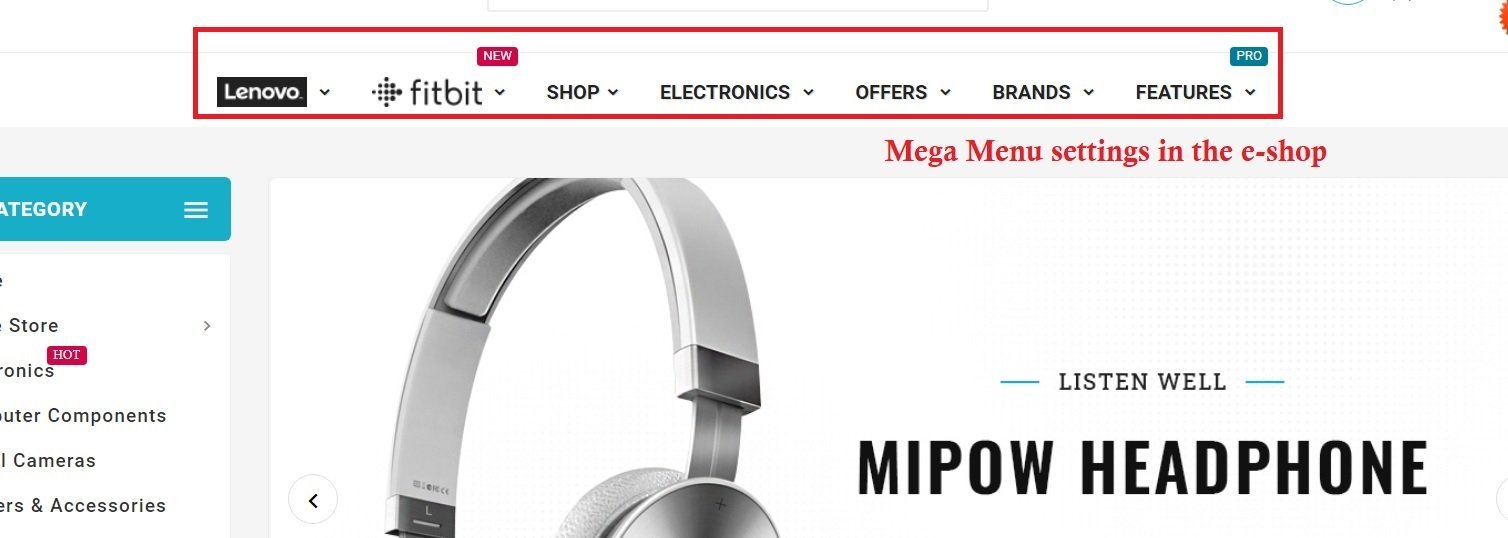

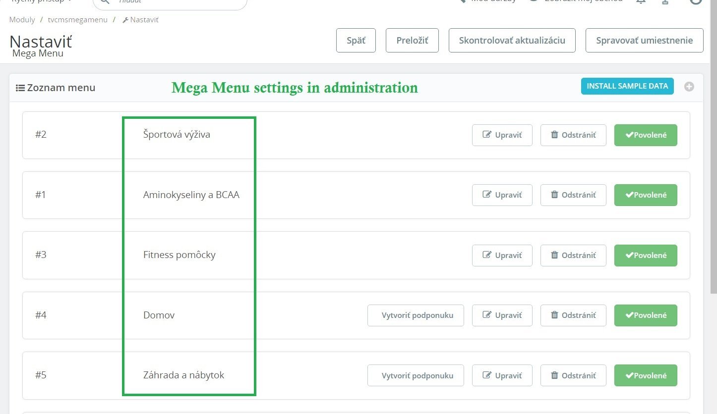

Peter.31 Posted May 7, 2022 Share Posted May 7, 2022 Hello, I bought a theme from Addons https://addons.prestashop.com/en/electronics-computers-themes/41948-electroplus-mega-electronicshightech-super-store.html. I can't get this topic up and running because it has constantly a problem. I'm currently having an issue with the "Mega Menu" theme module. When saving the settings in the Mega Menu, the change will be reflected in the administration, but in the e-shop (in the front office) this change will not be reflected. Can you advise me on how to solve this problem? ThemeVolty has the same or similar themes I am sending you pictures in the attachment of this message. Best regards Link to comment Share on other sites More sharing options...

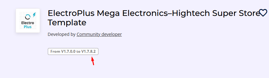

JavierP Posted May 7, 2022 Share Posted May 7, 2022 hace 19 minutos, Peter.31 dijo: PHP version 7.3, PS version 1.7.8.5. Your template may not be fully compatible with the latest version of prestashop...you should talk to the template developer... Link to comment Share on other sites More sharing options...
Peter.31 Posted May 7, 2022 Author Share Posted May 7, 2022 I also used the theme in version 1.7.8.2 and the theme also didn't work properly for me. Link to comment Share on other sites More sharing options...
