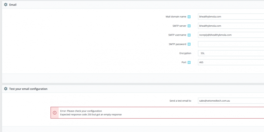

VMT Posted April 25, 2022 Share Posted April 25, 2022 Hi all, We've recently started getting no emails when orders are placed and unable to update order status with emails. This was working fine via SMTP. When in the backoffice and testing the error we get is: Error: Please check your configuration Expected response code 250 but got an empty response As our Siteground email details and our Prestashop details match, as well as searching for solutions through this forum to no avail, I was hoping to get some advice on what could be the problem. Link to comment Share on other sites More sharing options...

VMT Posted May 11, 2022 Author Share Posted May 11, 2022 Hi, On 5/10/2022 at 3:08 PM, ComGrafPL said: To set this correctly in SMTP, you need to place main email address. We have attempted noreply@ admin@ and test@ to no avail. On 5/10/2022 at 3:08 PM, ComGrafPL said: Is your prestashop admin email is "[email protected]"? To set this correctly in SMTP, you need to place main email address. Also "Send test email to" must be same as SMTP username. I believe you are mistaken here. The send test email to field is the address to which the test email is sent to, from the SMTP setting email address. We have attempted to: - Update to 1.7.8.5 - Both automatically and manually deleted the cache from var/cache - Flushed our Siteground webhost's cache. - Confirmed multiple types of SMTP settings with Siteground, all feature the same connection issue. However it does also change the error correctly when the wrong password is used. So all 'correct' settings give the above error. Error: Please check your configuration Expected response code 250 but got an empty response Link to comment Share on other sites More sharing options...
