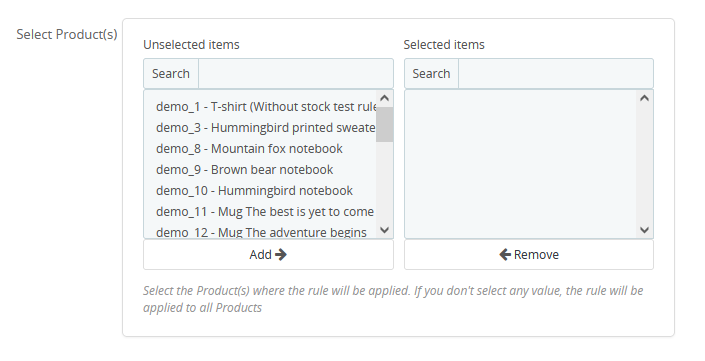

On 4/20/2022 at 4:58 PM, idnovate.com said:
Hi. I checked this module demo. This is not practical because our client has more than 40,000 products. And a lot of customers. But in this module there is only one box of products and customers without any search option. So we had to figure this out by our self. Thanks for your reply.
There was a bug in some browsers 😅
It's fixed now:
