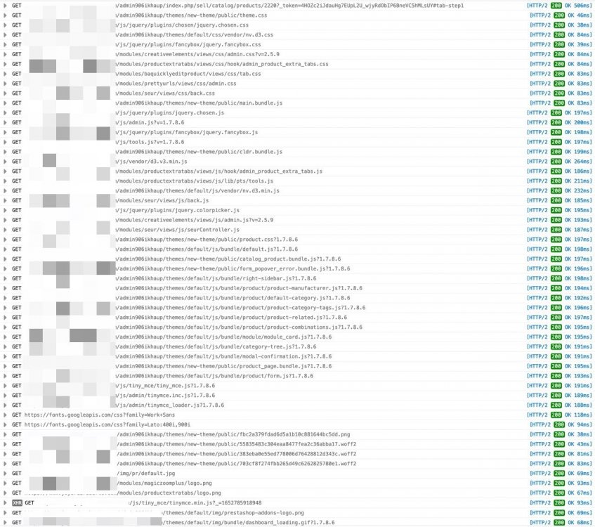

With the update to 1.78.5 i have serious problem saving Short Description and Description in one of my websites.

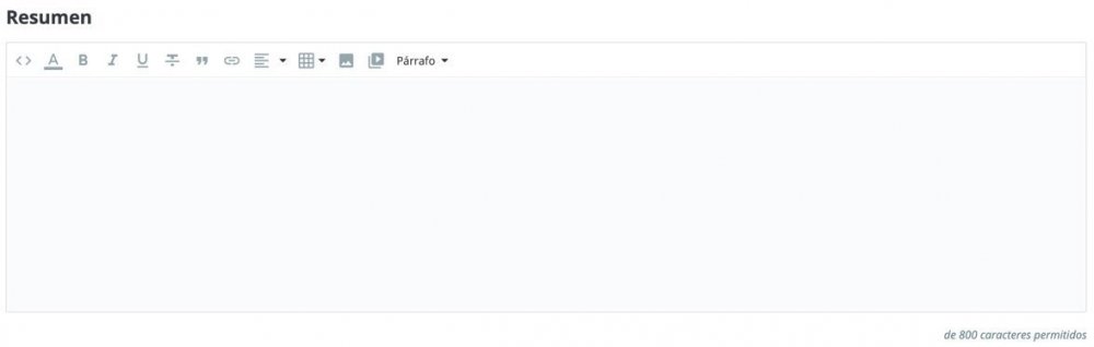

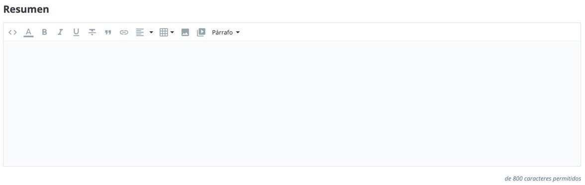

I have detected that when I try to add a new product, if I see the "Resumen / Short Description" field as in this screenshot, anything I enter is NOT SAVED in the database.

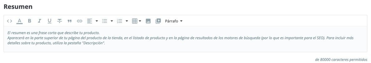

But if I look at the field as follows, everything works normally.
I have tried disabling overrides, disabling many of the modules... and nothing seems to work.

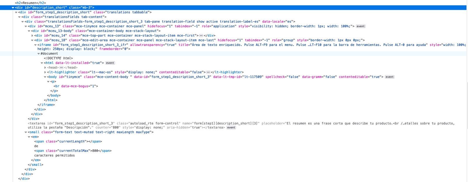

If I inspect the field I see this code:
I'm going crazy locating the error, any help is welcome!

I update to last version (1.7.8.6) and updated all modules... and i have the same problem. I can't save Short Description and Description. I need to disable javascript to change this fields values. Any idea how i can debug this problem?

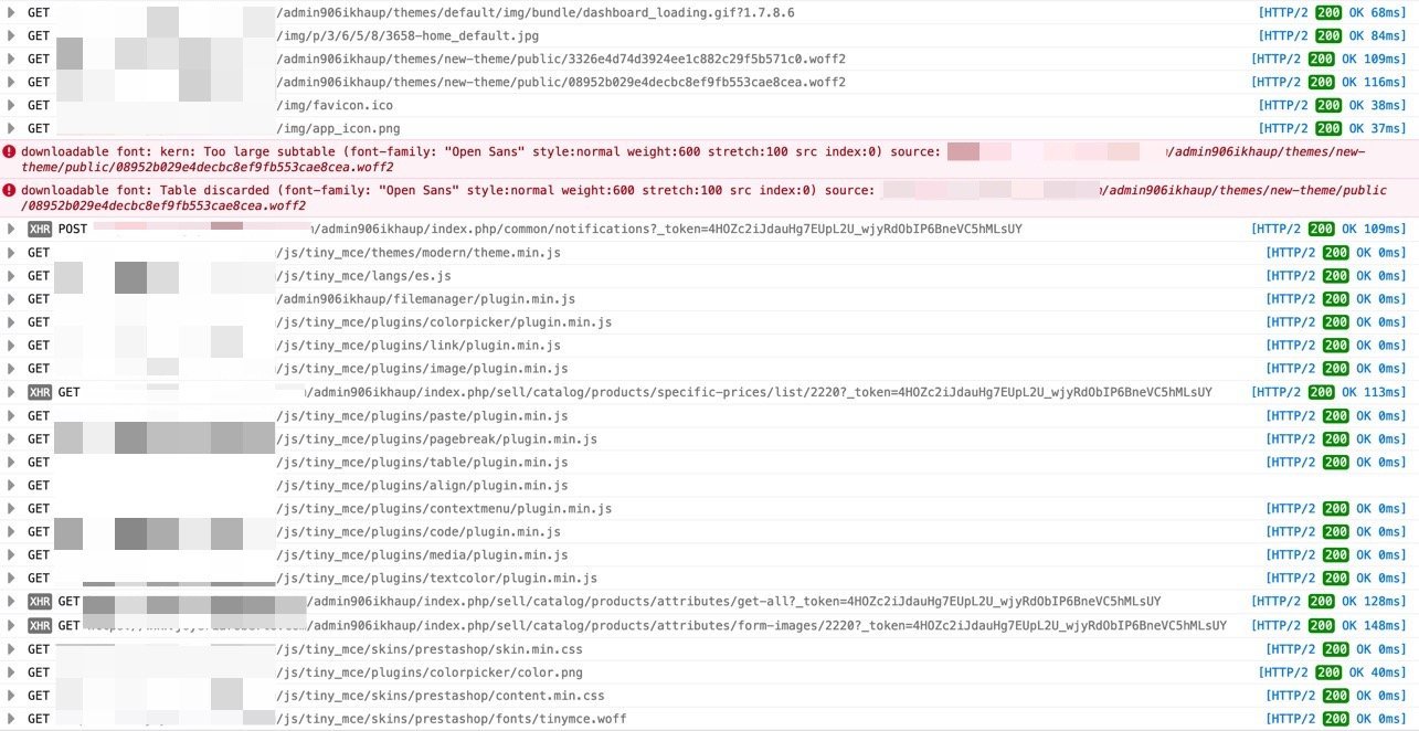

I have made a copy of the website in local and disabled one by one all the plugins... the problem persists. The only way to save data in those two fields is to temporarily disable javascript... it's crazy.
