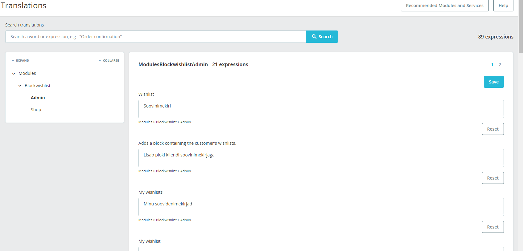

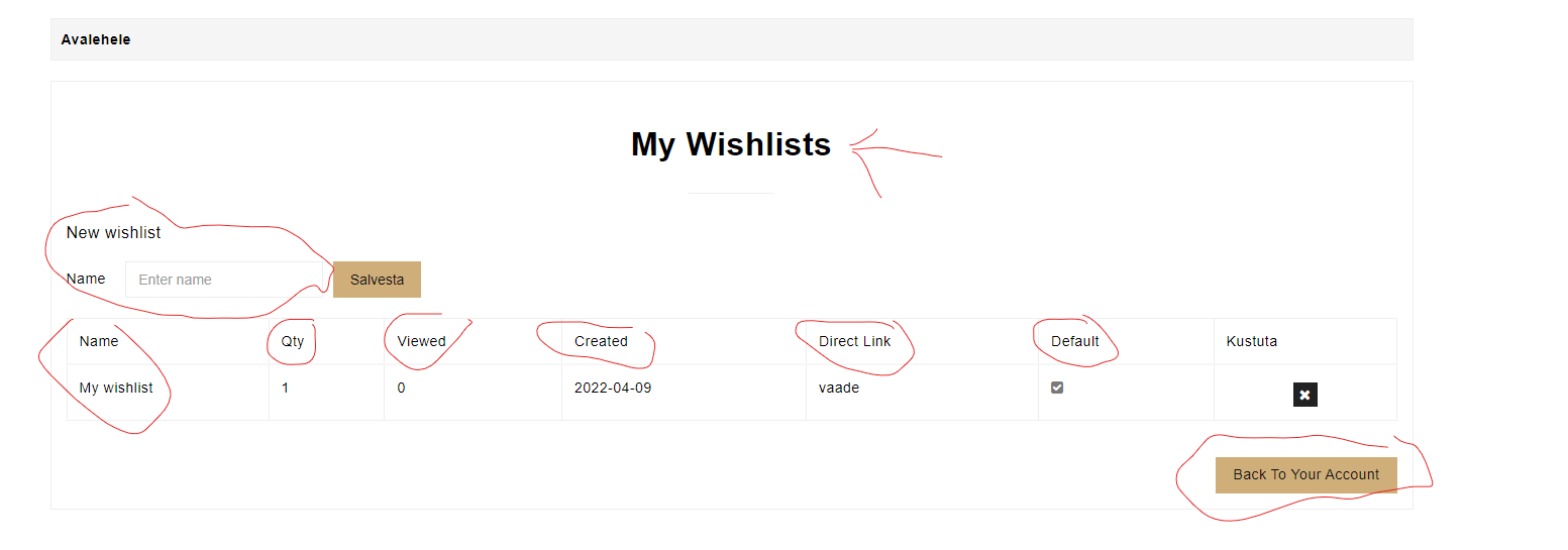

janeklass Posted April 9, 2022 Share Posted April 9, 2022 How to translate all this (see picture) I translated the entire wishlist block in the prestashshop, but it doesn't work. Link to comment Share on other sites More sharing options...
janeklass Posted April 9, 2022 Author Share Posted April 9, 2022 2 hours ago, ndiaga said: Hi, It depends on the module and theme you are using. Did you check the theme translation? Yes, I have the module and theme translated, but that didn't change anything. Link to comment Share on other sites More sharing options...
ComGrafPL Posted April 9, 2022 Share Posted April 9, 2022 Are you using classic theme? If not, try also find missing translations in classic one. Did you clear the cache after translation ( also check it on other internet browser ). Maybe need to clear browser cache. Link to comment Share on other sites More sharing options...
janeklass Posted April 9, 2022 Author Share Posted April 9, 2022 24 minutes ago, ComGrafPL said: Are you using classic theme? If not, try also find missing translations in classic one. Did you clear the cache after translation ( also check it on other internet browser ). Maybe need to clear browser cache. No I don't use a classic theme. I found a solution. The file mywishlist.tpl had to be modified /modules/blockwishlist/views/templates/front Link to comment Share on other sites More sharing options...
