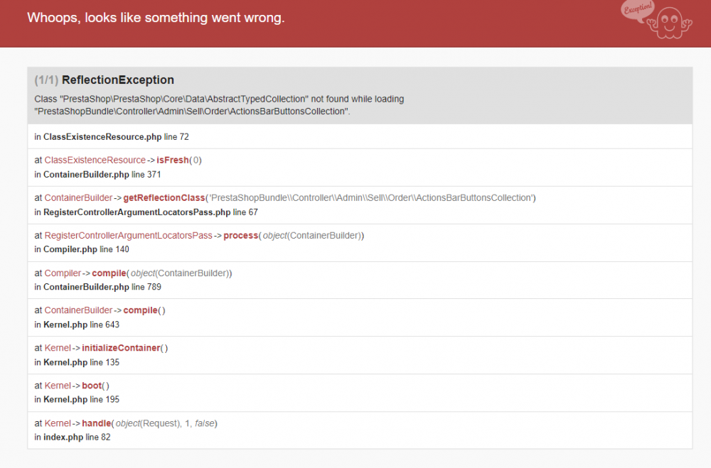

sandra nanou Posted April 7, 2022 Share Posted April 7, 2022 Hi, My BO is totally down when I activat Debug Mode. It happened after a migration. Php version is 7.1, Prestashop is 1.7.8.1: Class "PrestaShop\PrestaShop\Core\Data\AbstractTypedCollection" not found while loading "PrestaShopBundle\Controller\Admin\Sell\Order\ActionsBarButtonsCollection". I emptied anually the cache folders. What else could I try? Thank you! Link to comment Share on other sites More sharing options...

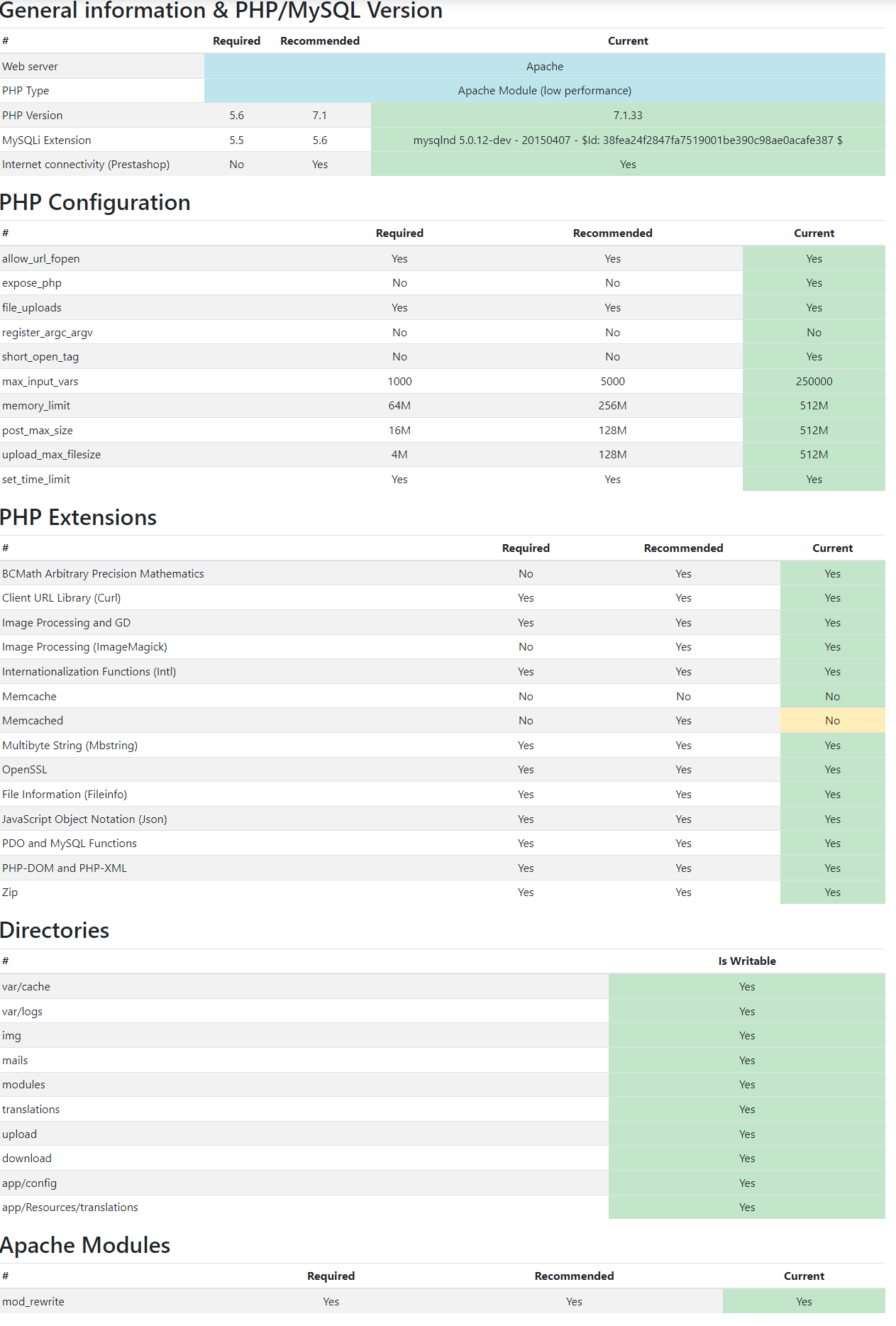

sandra nanou Posted April 8, 2022 Author Share Posted April 8, 2022 Hello, No I migrated from OVH to O2Switch, from 2 different subdomains. I don't have this error in the dev environnment and it seems like all files have been transfered correctly, no error in the database and I check the requirements : I have tried to empty caches many times manually. I wish I could have more information on this error ! Thank you for your help, Sandra Link to comment Share on other sites More sharing options...
idnovate.com Posted April 8, 2022 Share Posted April 8, 2022 Check if you have file /src/Core/Data/AbstractTypedCollection.php Link to comment Share on other sites More sharing options...
sandra nanou Posted April 8, 2022 Author Share Posted April 8, 2022 The file is there, yes. Link to comment Share on other sites More sharing options...
Nickz Posted April 8, 2022 Share Posted April 8, 2022 2 hours ago, sandra nanou said: The file is there, yes. php -m will give you all the modules, and php -i will give you a lot more detailed information on what the current configuration. Source Link to comment Share on other sites More sharing options...
