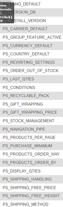

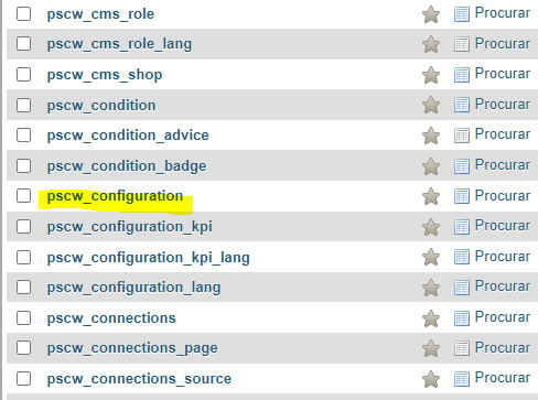

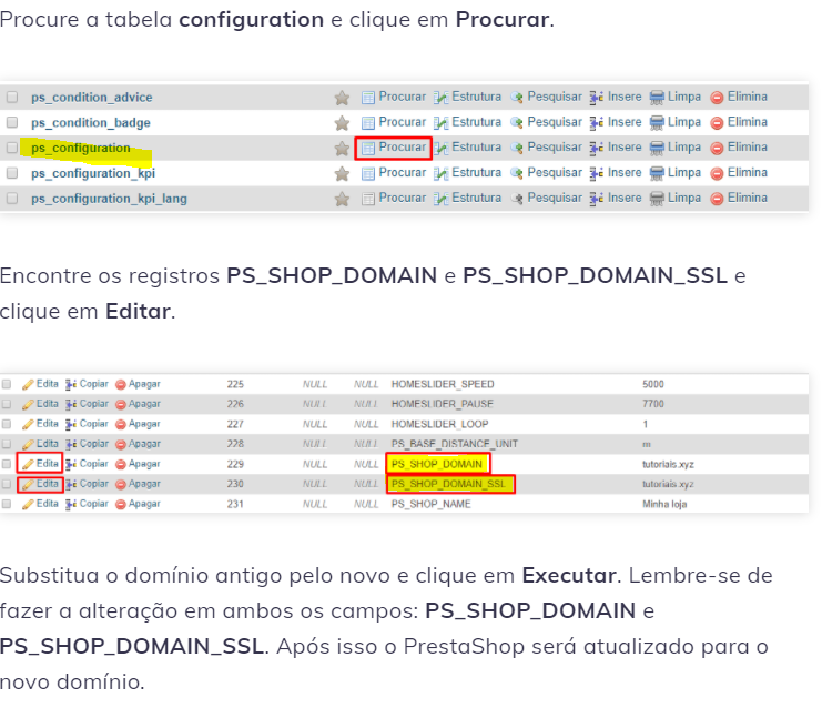

Catarina123 Posted April 1, 2022 Author Share Posted April 1, 2022 I found this configuration, as a suggestion, but in my database, it doesn't appear, the PS_SHOP_DOMAIN and PS_SHOP_DOMAIN_SSL. can anyone help? Link to comment Share on other sites More sharing options...
Rhobur Posted April 2, 2022 Share Posted April 2, 2022 It has to be there otherwise your shop wouldn't work. Run this query SELECT * FROM `ps_configuration` WHERE name LIKE '%domain%' in phpmyadmin or mysql console and change those values. Then update the values in the ps_shop_url as well. Link to comment Share on other sites More sharing options...
