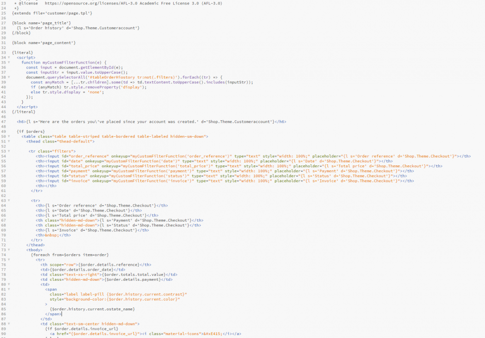

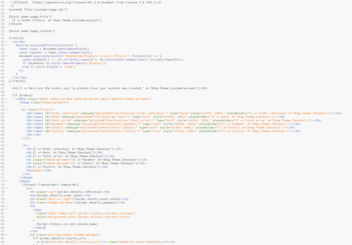

ps8modules.com Posted March 11, 2022 Share Posted March 11, 2022 And how can I help if I don't see what and where you copied, if you really changed everything the way I wrote, etc.? I don't see what you see !!! Make a screen ..... Link to comment Share on other sites More sharing options...
Martin511 Posted March 11, 2022 Author Share Posted March 11, 2022 Link to comment Share on other sites More sharing options...
ps8modules.com Posted March 11, 2022 Share Posted March 11, 2022 Link to comment Share on other sites More sharing options...
ps8modules.com Posted March 11, 2022 Share Posted March 11, 2022 <table class="table table-striped table-bordered table-labeled hidden-sm-down" id="tableOrderHiostory"> are you missing id="tableOrderHiostory" Link to comment Share on other sites More sharing options...
Martin511 Posted March 11, 2022 Author Share Posted March 11, 2022 7 minutes ago, 4you.software said: <table class="table table-striped table-bordered table-labeled hidden-sm-down" id="tableOrderHiostory"> are you missing id="tableOrderHiostory" That´s it! Now it works! Thank you!!! Link to comment Share on other sites More sharing options...
