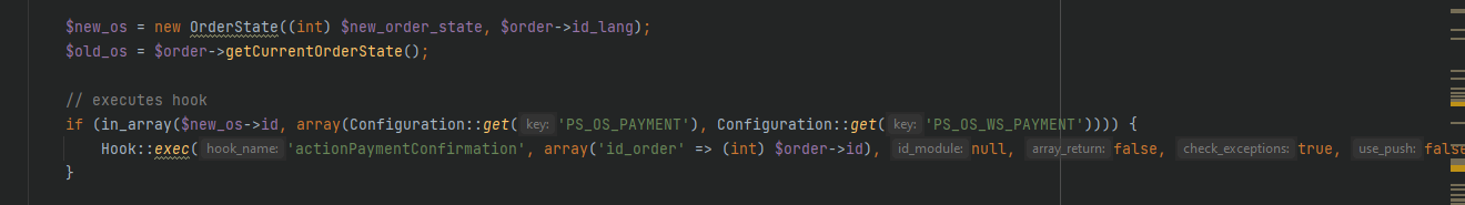

RensR Posted February 21, 2022 Share Posted February 21, 2022 I'm happy for help you, Some people report that they had to make modifications to this hook when using "Custom order states". if you have any problem you can check the code in /classes/order/orderHistory.php changeIdOrderState() 1 Link to comment Share on other sites More sharing options...
