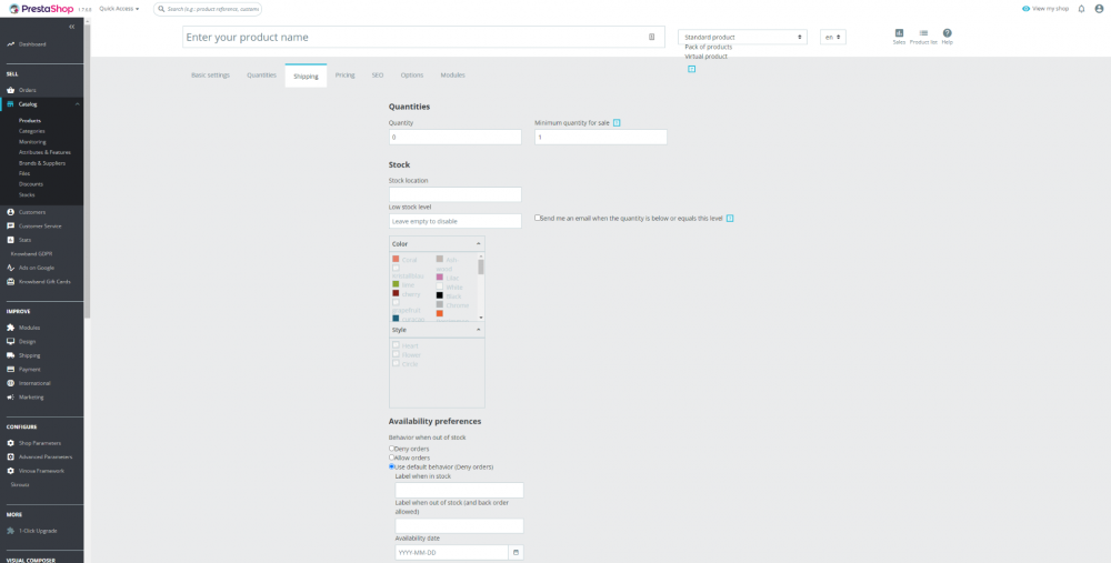

alexis_gyf Posted February 20, 2022 Share Posted February 20, 2022 (edited) Hello After migration to another server my dashboard looks like missing css etc. Prestashop 1.6.7.8 PHP 7.2.34 (same) Any idea? Edited February 22, 2022 by alexis_gyf (see edit history) Link to comment Share on other sites More sharing options...

alexis_gyf Posted February 21, 2022 Author Share Posted February 21, 2022 Hello, nothing changed Maybe on transfer via ftp some files are missing Link to comment Share on other sites More sharing options...

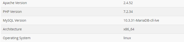

endriu107 Posted February 21, 2022 Share Posted February 21, 2022 You can try override all admin folder maybe it helps. But whenever I see issue with dropdowns not fit in input it was always been to height PHP version. Link to comment Share on other sites More sharing options...
alexis_gyf Posted February 21, 2022 Author Share Posted February 21, 2022 PHP on previous server was 7.2 and on this one is 7.4 You think that maybe this is the issue? Link to comment Share on other sites More sharing options...
alexis_gyf Posted February 21, 2022 Author Share Posted February 21, 2022 Actually it was PHP version. I return it to 7.2 and everything looks ok Link to comment Share on other sites More sharing options...
