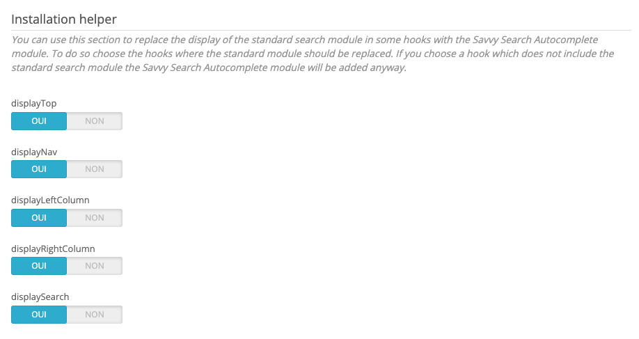

ComGrafPL Posted February 14, 2022 Share Posted February 14, 2022 Check search module setting either hooks. Link to comment Share on other sites More sharing options...
SmartDataSoft Posted February 15, 2022 Share Posted February 15, 2022 You can check module position and that particular module hooks exception. Is their any exception set or not. Secondly you can reset the module and re-possition the hook. Because their is no data related to this module ,which will lost when reset. Thank you Link to comment Share on other sites More sharing options...
ozztrigz Posted February 15, 2022 Author Share Posted February 15, 2022 Thank you for your suggestions. I played with the hooks but wasn't able to solve my initial problem. It turns out it's a module called “savvy search autocomplete”. Anyhow, I can get it to show up on the homepage no problem but for some reason, It won't display in other pages. It has parts of it in the product pages, but it's missing the main input field ?!?!?! Home page code: <form method="get" action="https://espacehabitationgbi.com/en/search" _lpchecked="1"> <input type="hidden" name="controller" value="search"> <input type="hidden" name="orderby" value="position"> <input type="hidden" name="orderway" value="desc"> <input type="text" class="ssa-search-query ssa-search-query-input form-control" name="search_query" value="" placeholder="Search"> <button type="submit" name="ssa_submit" class="btn btn-default button-search ssa-button-search"> <span class="material-icons search">Search</span> </button> </form> Other page code: <form method="get" action="https://espacehabitationgbi.com/en/search"> <input type="hidden" name="controller" value="search"> <input type="hidden" name="orderby" value="position"> <input type="hidden" name="orderway" value="desc"> </form> I'm guessing there could have been some customization done, but I can't seem to figure out where to look first. Link to comment Share on other sites More sharing options...
