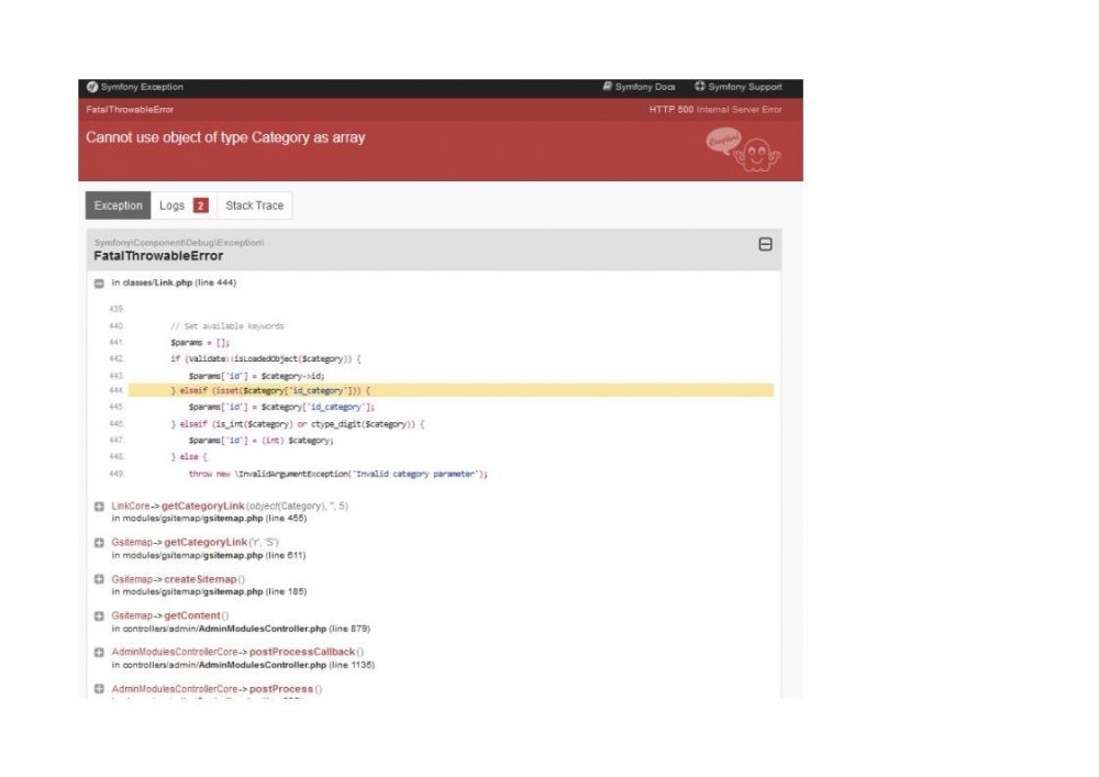

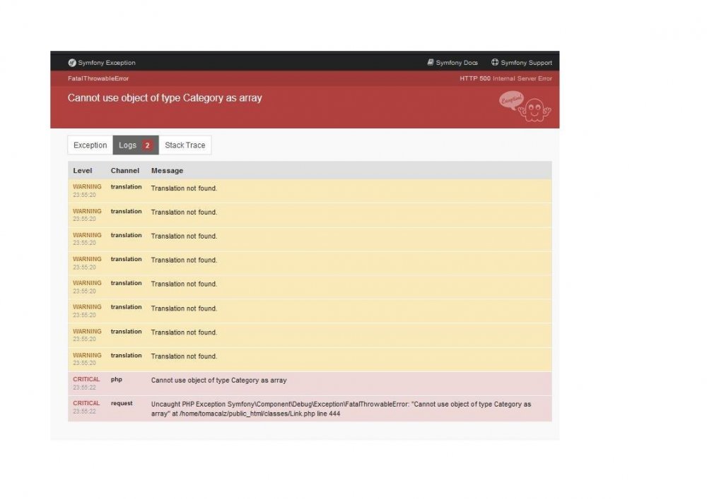

TOMACALZATURE Posted March 1, 2022 Share Posted March 1, 2022 Ciao, ti ringrazio per averi risposto rapidamente. Non sono molto pratico di Prestashop. Ti allego gli screenshot dove penso siamo elencati gli errori. Link to comment Share on other sites More sharing options...

disarci Posted July 14, 2023 Share Posted July 14, 2023 Hi, problem with the post was the module gsitemap post your error 500 with debug and see which module cause the error Link to comment Share on other sites More sharing options...
