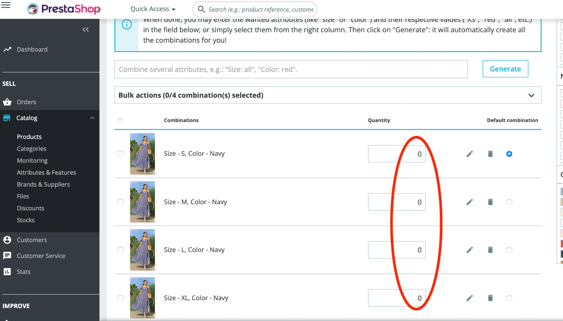

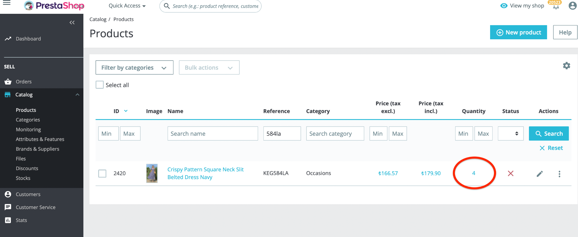

ifs-net Posted February 9, 2022 Share Posted February 9, 2022 Hello, 1. step: When create a product with combinations for example S M L XL, 1 piece for each size for example, means that you will have 4 in stock in total 2. step: then if you delete these combinations and go to the product list under "catalog>products", there are still 4 pieces seen under "Quantity" column 3. step: and after if you generate new combinations , and add new quantity , that new quantity has added on top of the deleted 4. For example if you generated new 4 combination , you will see 8 at products list but infact you only have 4. How can we fix that pls? prestashop 1.7.7.8 Link to comment Share on other sites More sharing options...
