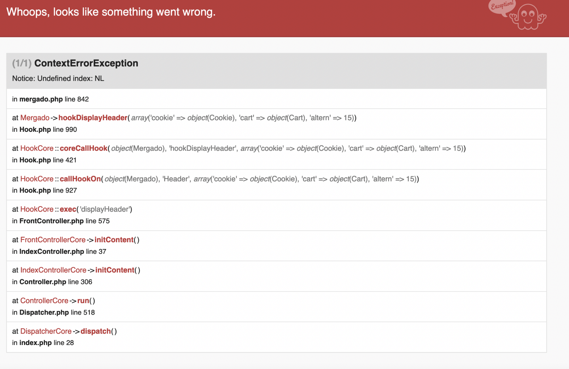

kobemi1987 Posted February 3, 2022 Share Posted February 3, 2022 Hello, I have the following problems after moving prestashop to another hosting. Domain You can see the errors attached. I am not developer, that is why I need your help. I tried to change php from 7.2/7.3/7.4, but it does not help. Link to comment Share on other sites More sharing options...
endriu107 Posted February 3, 2022 Share Posted February 3, 2022 If you have debug mode on try turn it off. Link to comment Share on other sites More sharing options...
JBW Posted February 3, 2022 Share Posted February 3, 2022 Its just a notice and will disapper as soon debug is off. But seems to be caused by a module "Mergado" - contact the developer to fix it Link to comment Share on other sites More sharing options...
