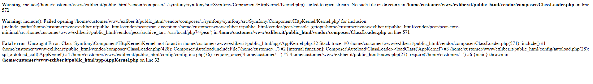

juanrojas Posted February 1, 2022 Share Posted February 1, 2022 enable degub via ftp Link to comment Share on other sites More sharing options...
Exliber Posted February 1, 2022 Author Share Posted February 1, 2022 Ok, done. This is what happens now when I log into the site. Link to comment Share on other sites More sharing options...

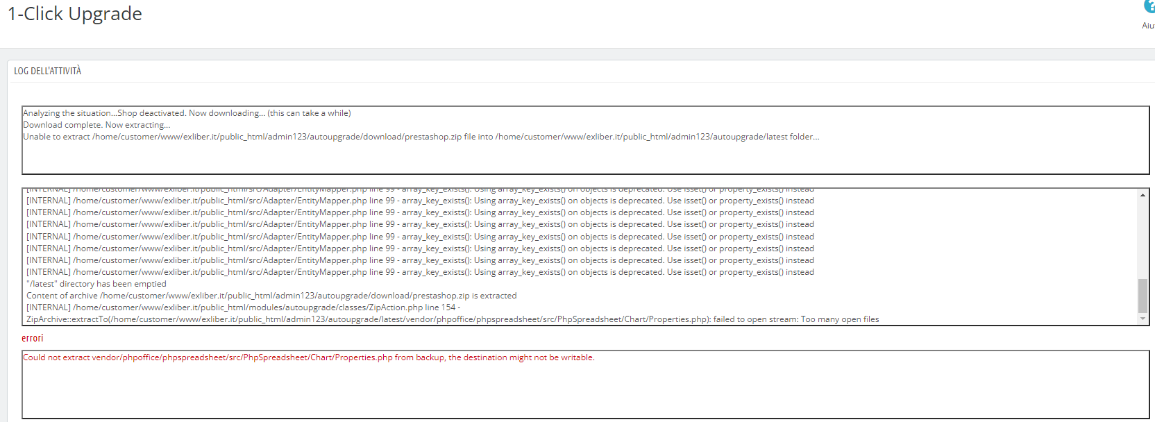

Exliber Posted February 1, 2022 Author Share Posted February 1, 2022 Ok, now I have restored the BO. But i can't upgrade Prestashop because of this trouble. Can you help me to upgrade it? Link to comment Share on other sites More sharing options...

Exliber Posted February 2, 2022 Author Share Posted February 2, 2022 How can I select manually update from zip? Now, I have put my prestashop.zip in admin/autoupgrade/download directory. Link to comment Share on other sites More sharing options...
