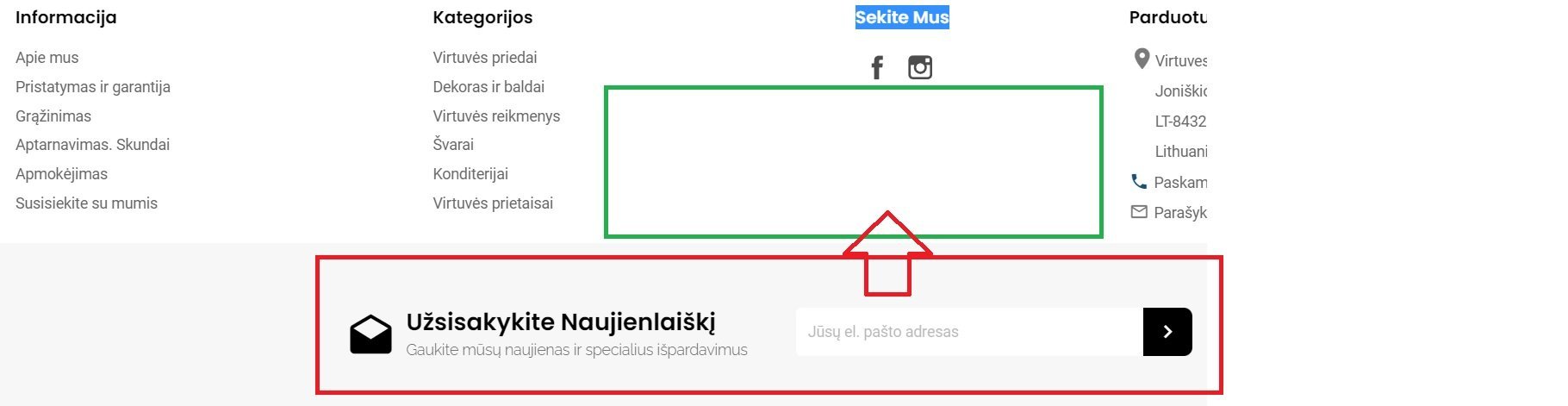

rimstaske Posted January 10, 2022 Share Posted January 10, 2022 I think I caught more and more in this 'prestashop world' :d.. I talking about, i fixed more e-shop things without programming knowloadge. But this challenge I thing is hardest. Question: Is it possible to move the 'newsletter' (red marked) to the specified location (green marked)? I think I know since where would need to start solve this, but... It could cost too much time to solve. I will be grateful for any reply. Link to comment Share on other sites More sharing options...
SmartDataSoft Posted January 11, 2022 Share Posted January 11, 2022 Hello, Which PrestaShop version you are using. You can check the module position and try to transplant the module from displayFooter and position . It may work. Thank you Link to comment Share on other sites More sharing options...
rimstaske Posted January 11, 2022 Author Share Posted January 11, 2022 1.7.6.9 Link to comment Share on other sites More sharing options...
SmartDataSoft Posted January 11, 2022 Share Posted January 11, 2022 24 minutes ago, rimstaske said: 1.7.6.9 You need to position that first https://prnt.sc/26ccg5h and then you need to change the column size from theme\template file or you can do that from child theme. 1.7.7.7/themes/classic/modules/ps_emailsubscription/views/templates/hook/ps_emailsubscription-column.tpl Thank you Link to comment Share on other sites More sharing options...
