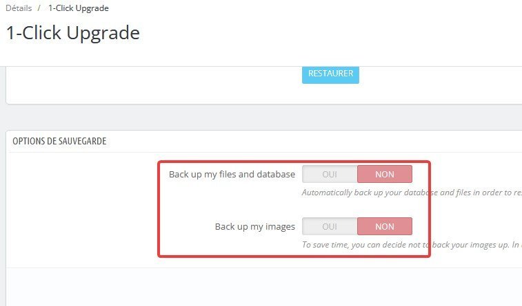

magicbel Posted December 27, 2021 Share Posted December 27, 2021 (edited) Quand vous effectuez la mise à jour, décochez dans le module Click_upgrade les options de Backup. Effectuez vous même le backup AVANT la mise à jour. Edited December 27, 2021 by magicbel (see edit history) Link to comment Share on other sites More sharing options...
Céline N Posted December 28, 2021 Author Share Posted December 28, 2021 Bonjour, Je vous remercie pour votre conseil, malheureusement toujours le même message : "Could not close the Zip file properly. Check you are allowed to write on the disk and there is available space on it." Link to comment Share on other sites More sharing options...
