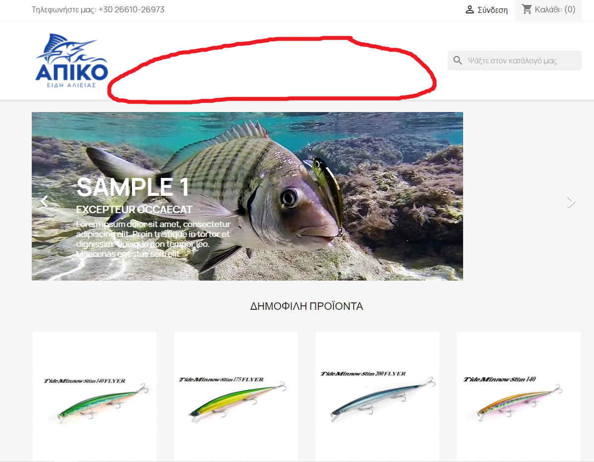

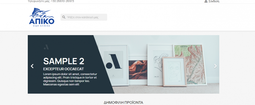

Smalldio Posted December 13, 2021 Share Posted December 13, 2021 Hello every one I have finished the configuration and in the preview I saw that the main menu does not appear I use the Classic theme Ver 1.0.0 The version I have in PRESTA is 1.7.8.1 Any help is welcome Link to comment Share on other sites More sharing options...
Mr Rick Posted December 14, 2021 Share Posted December 14, 2021 Hi, Did you try resetting the menu module? do send us a link to website so we can check it. Link to comment Share on other sites More sharing options...
Smalldio Posted December 14, 2021 Author Share Posted December 14, 2021 Thanks for your answer I have reset the module but still nothing Here is the link https://apikofishing.gr Link to comment Share on other sites More sharing options...

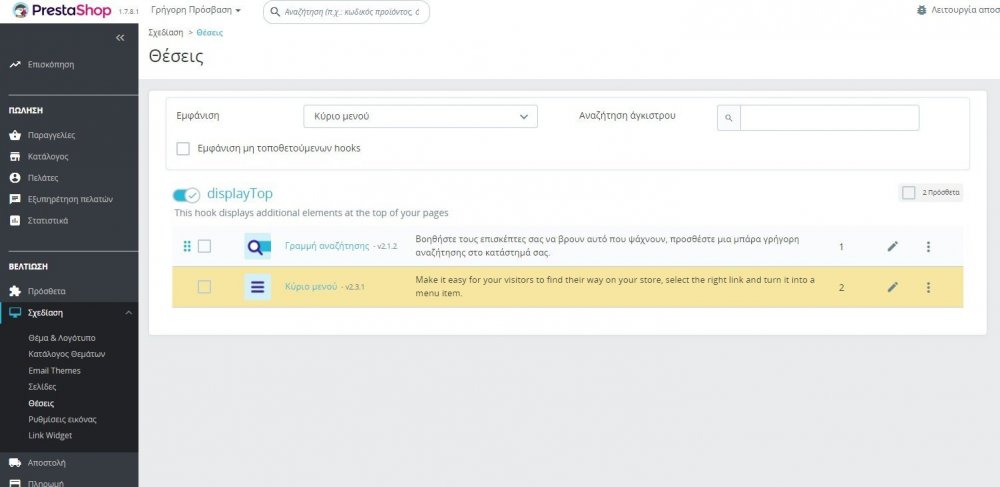

JBW Posted December 14, 2021 Share Posted December 14, 2021 Your shop is in maintainance mode. Check if the module is attached to the correpsonding hook Link to comment Share on other sites More sharing options...

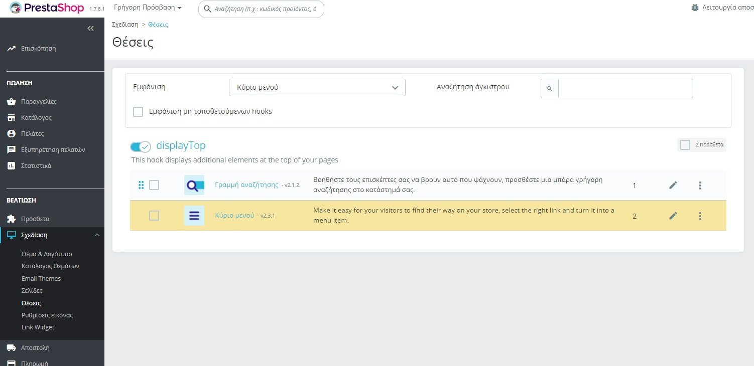

Smalldio Posted December 14, 2021 Author Share Posted December 14, 2021 Thanks for your response Now the shop is in normal mode . You could check it The module is attached to the displayTop hook Link to comment Share on other sites More sharing options...
JBW Posted December 15, 2021 Share Posted December 15, 2021 Usually the menu is before the search widget. But anyway I see menu code is on the page but the content is empty - after resetting you might have to add the items again Link to comment Share on other sites More sharing options...

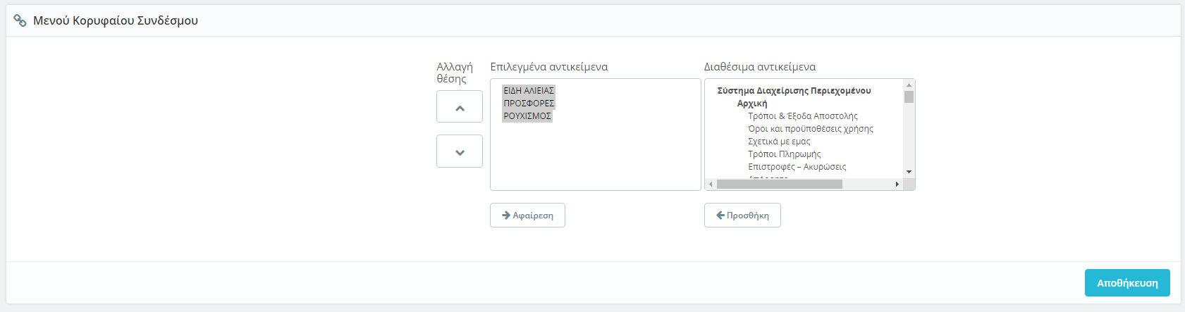

Smalldio Posted December 15, 2021 Author Share Posted December 15, 2021 (edited) The module has been reset but again nothing appears Edited December 15, 2021 by Smalldio (see edit history) Link to comment Share on other sites More sharing options...

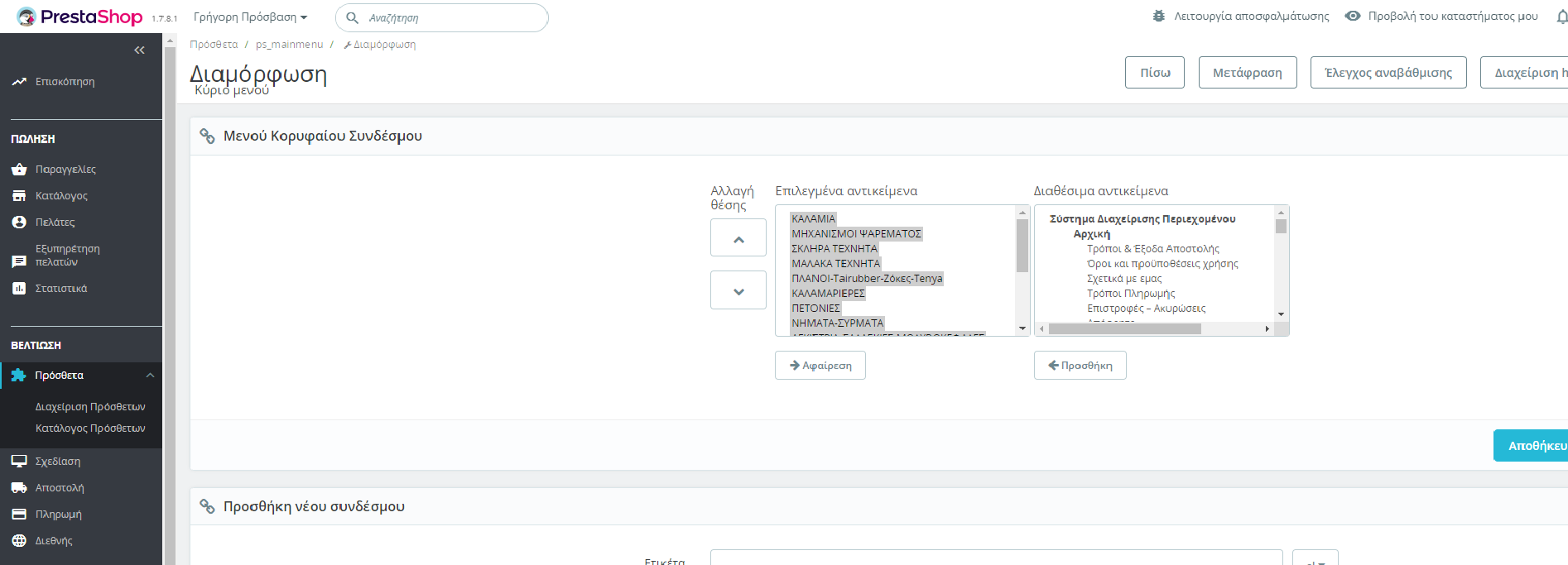

JBW Posted December 15, 2021 Share Posted December 15, 2021 Have you maybe deleted this standard categories? Try again to add your own menu elements in the module settings Link to comment Share on other sites More sharing options...

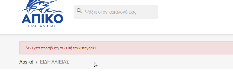

Smalldio Posted December 15, 2021 Author Share Posted December 15, 2021 Link to comment Share on other sites More sharing options...

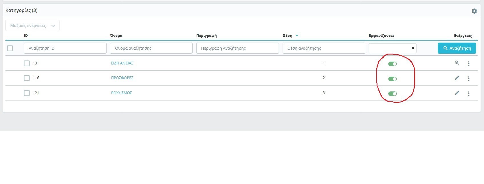

JBW Posted December 15, 2021 Share Posted December 15, 2021 https://apikofishing.gr/index.php?id_category=13&controller=category Link to comment Share on other sites More sharing options...
Smalldio Posted December 15, 2021 Author Share Posted December 15, 2021 (edited) Thanks again Because of your last message I began to search and found the answer . There is a bug with the Greek translation Solution Edited December 15, 2021 by Smalldio (see edit history) Link to comment Share on other sites More sharing options...
