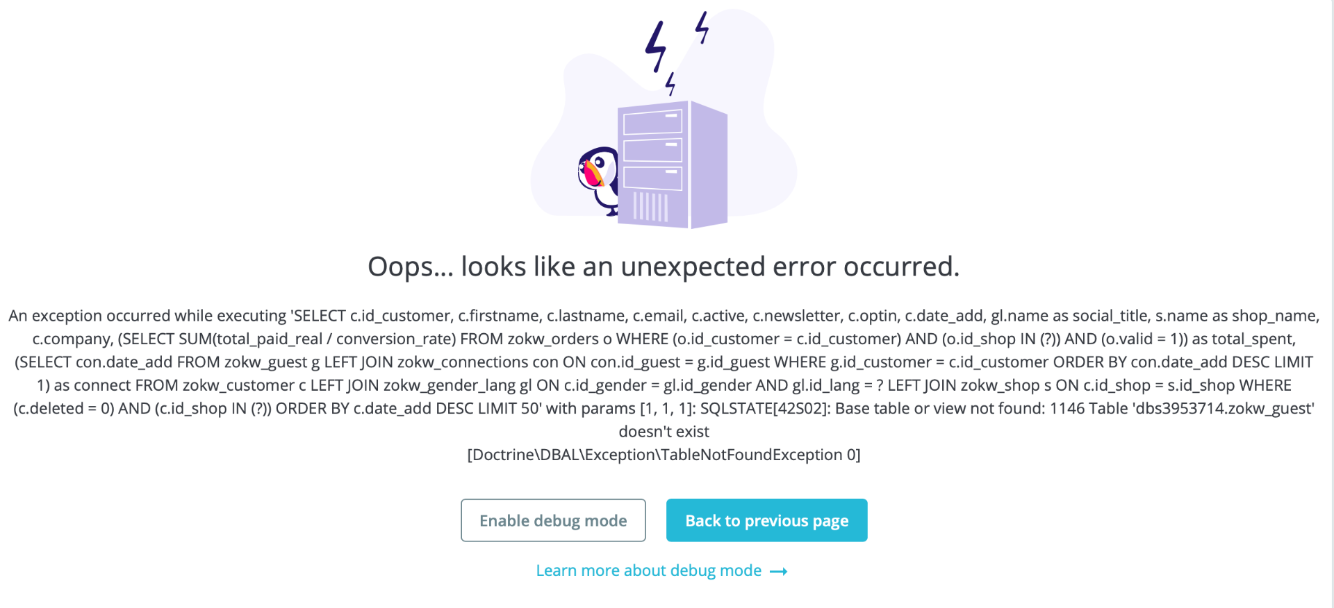

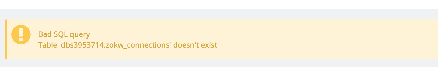

Tim Eyselbergs Posted November 16, 2021 Share Posted November 16, 2021 Hello, I recently had to restore a backup of my database (after having problems with version 1.7.8.0). Currently i have updated again to version 1.7.8.1 but still experiencing the problem. When i hit customers or shopping carts i get the 2 errors you can see in the screenshot. I did some digging and it looks like something with the "connections" table? However, no idea on how to solve this. Can anyone help me out? Link to comment Share on other sites More sharing options...

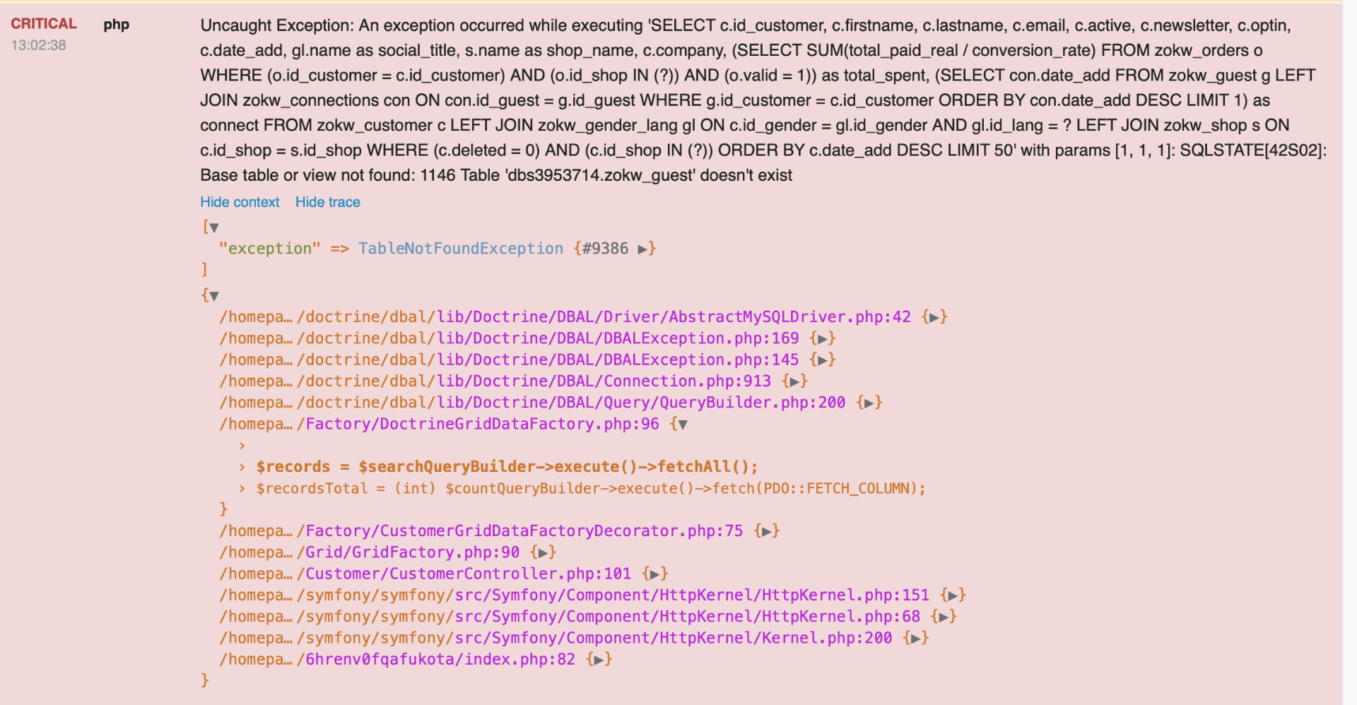

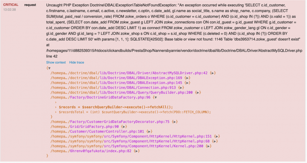

Tim Eyselbergs Posted November 17, 2021 Author Share Posted November 17, 2021 13 minutes ago, ndiaga said: Hi, Please click on "Enable debug mode" and then report to us the error you have. Hello, Thanks for that. The 2 errors i get you can see in the screenshots. Let me know if you need anything else! Link to comment Share on other sites More sharing options...
Tim Eyselbergs Posted November 17, 2021 Author Share Posted November 17, 2021 32 minutes ago, ndiaga said: Hi, There is a missing table zokw_guest . any recommendation on how to solve this? I am not that familiar with prestashop or sql. Link to comment Share on other sites More sharing options...

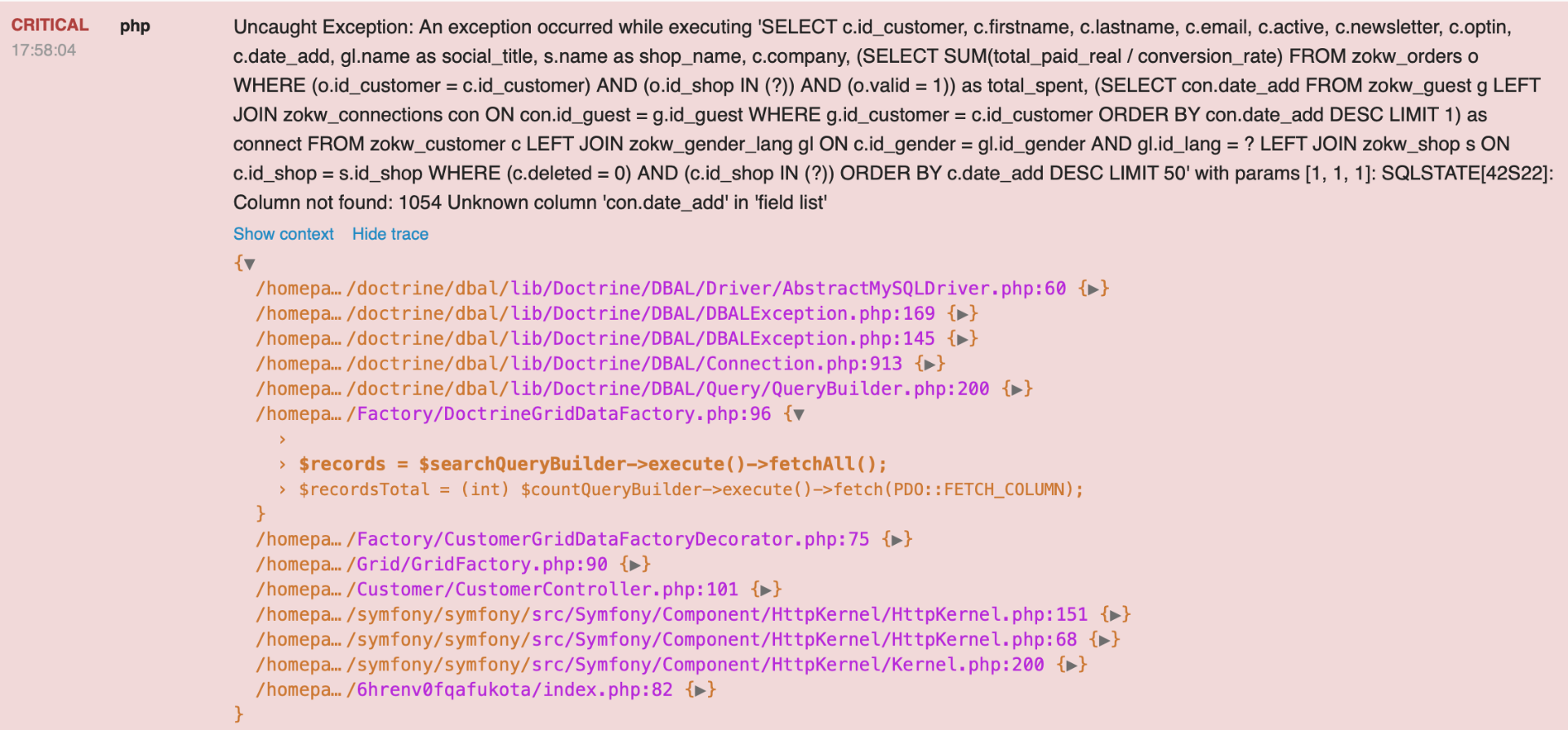

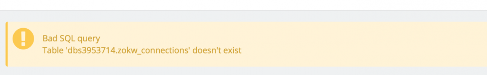

Tim Eyselbergs Posted November 18, 2021 Author Share Posted November 18, 2021 20 hours ago, ndiaga said: You can create that table again. Use the phpMyadmin and run this query : CREATE TABLE `zokw_guest` ( `id_guest` int(10) UNSIGNED NOT NULL, `id_operating_system` int(10) UNSIGNED DEFAULT NULL, `id_web_browser` int(10) UNSIGNED DEFAULT NULL, `id_customer` int(10) UNSIGNED DEFAULT NULL, `javascript` tinyint(1) DEFAULT '0', `screen_resolution_x` smallint(5) UNSIGNED DEFAULT NULL, `screen_resolution_y` smallint(5) UNSIGNED DEFAULT NULL, `screen_color` tinyint(3) UNSIGNED DEFAULT NULL, `sun_java` tinyint(1) DEFAULT NULL, `adobe_flash` tinyint(1) DEFAULT NULL, `adobe_director` tinyint(1) DEFAULT NULL, `apple_quicktime` tinyint(1) DEFAULT NULL, `real_player` tinyint(1) DEFAULT NULL, `windows_media` tinyint(1) DEFAULT NULL, `accept_language` varchar(8) DEFAULT NULL, `mobile_theme` tinyint(1) NOT NULL DEFAULT '0' ) ENGINE=InnoDB DEFAULT CHARSET=utf8; ok, thanks for that. I got a bit further, but still not working. So i executed your query, then i tried again and i basically got the same error but now for the ZOKW_connections table. I then ran your query again but not to make the zokw_connections table. Then that error went away but now i get the following one (see screenshot). any idea on how to proceed now? Link to comment Share on other sites More sharing options...
JBW Posted November 19, 2021 Share Posted November 19, 2021 It's usually only guest and connection tables as you can exclude them from backup (statistical data) - anyway looks like a bug if they do not get created at all at restore. Link to comment Share on other sites More sharing options...
