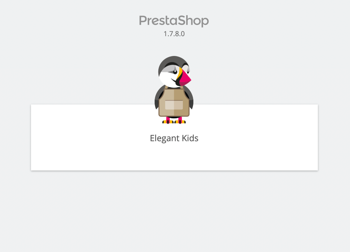

afsalthai Posted November 12, 2021 Share Posted November 12, 2021 (edited) back-office login redirect to blank page with prestashop logo tried few ways from forums, but no luck. Thanks in advance Edited November 15, 2021 by afsalthai solved (see edit history) Link to comment Share on other sites More sharing options...

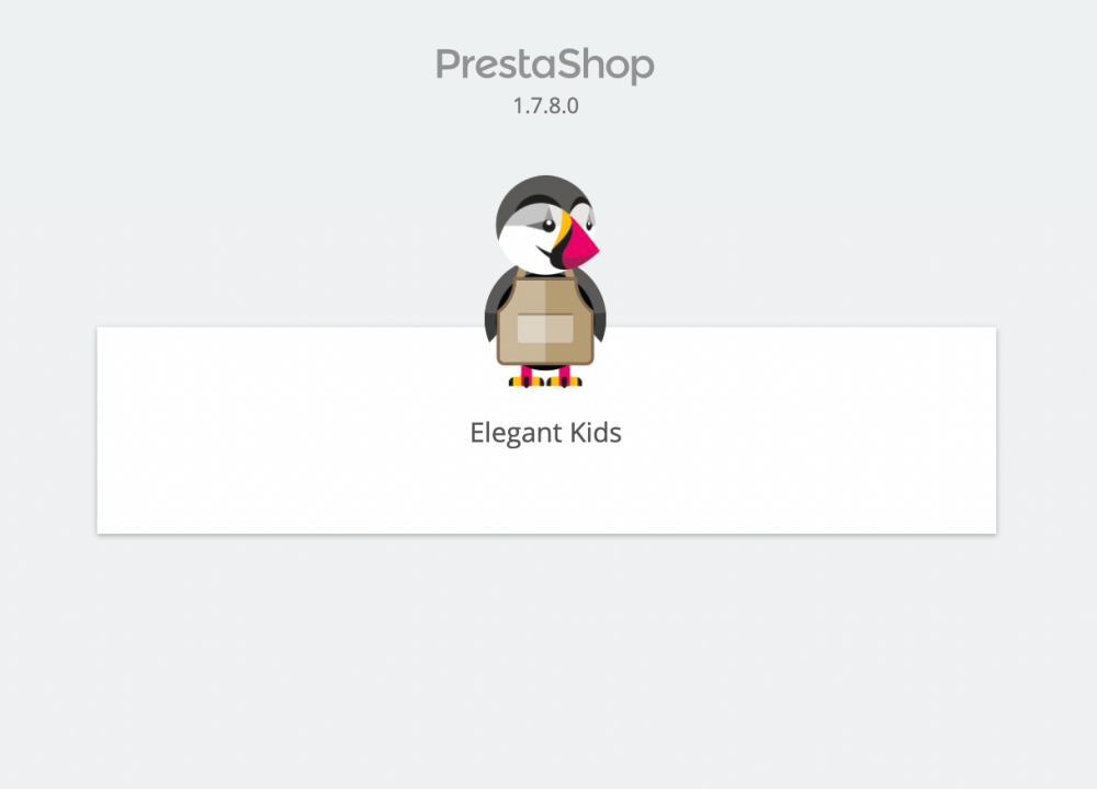

afsalthai Posted November 13, 2021 Author Share Posted November 13, 2021 (edited) This is fresh installation and I did multiple times already v. 1.7.8 PHP 7.3 Previous installation worked for 3 weeks and had same issue. It started after moving the installation folder. (Changed domain as well). I use shared hosting with bluehost Edited November 13, 2021 by afsalthai add a point (see edit history) Link to comment Share on other sites More sharing options...

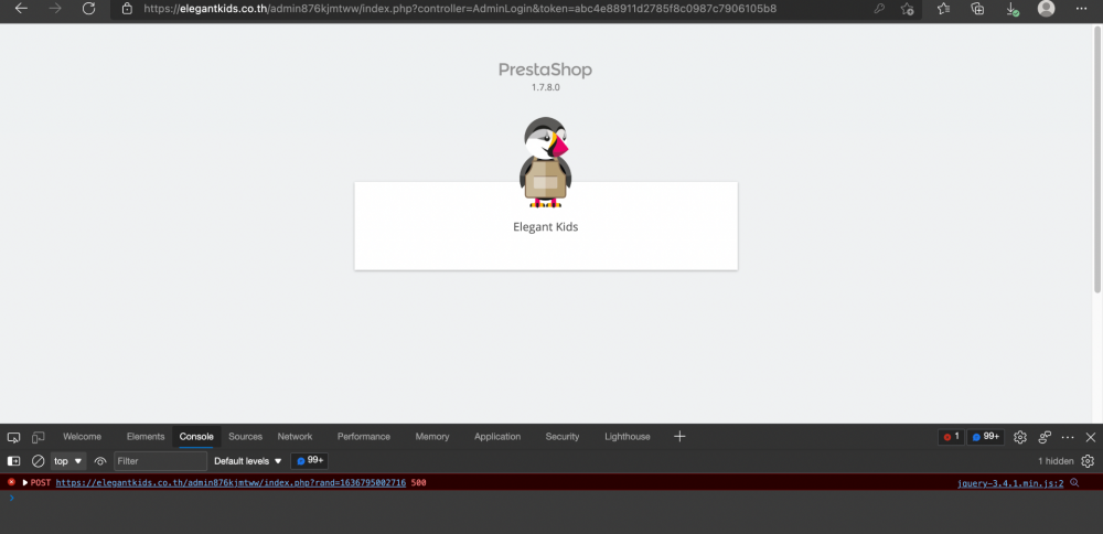

afsalthai Posted November 13, 2021 Author Share Posted November 13, 2021 the is is the error i'm getting in console after setting debug ON. POST https://elegantkids.co.th/admin876kjmtww/index.php?rand=1636795002716 500 jquery-3.4.1.min.js:2 send @ jquery-3.4.1.min.js:2 ajax @ jquery-3.4.1.min.js:2 (anonymous) @ login.js?v=1.7.8.0:186 r.complete @ jquery-3.4.1.min.js:2 c @ jquery-3.4.1.min.js:2 fireWith @ jquery-3.4.1.min.js:2 u @ jquery-3.4.1.min.js:2 k.fx.tick @ jquery-3.4.1.min.js:2 lt @ jquery-3.4.1.min.js:2 k.fx.start @ jquery-3.4.1.min.js:2 k.fx.timer @ jquery-3.4.1.min.js:2 dt @ jquery-3.4.1.min.js:2 a @ jquery-3.4.1.min.js:2 dequeue @ jquery-3.4.1.min.js:2 (anonymous) @ jquery-3.4.1.min.js:2 each @ jquery-3.4.1.min.js:2 each @ jquery-3.4.1.min.js:2 queue @ jquery-3.4.1.min.js:2 animate @ jquery-3.4.1.min.js:2 k.fn.<computed> @ jquery-3.4.1.min.js:2 doAjaxLogin @ login.js?v=1.7.8.0:185 submitHandler @ login.js?v=1.7.8.0:14 s @ jquery.validate.js:2 (anonymous) @ jquery.validate.js:2 dispatch @ jquery-3.4.1.min.js:2 v.handle @ jquery-3.4.1.min.js:2 Link to comment Share on other sites More sharing options...
Rhobur Posted November 13, 2021 Share Posted November 13, 2021 Hmm.. not very helpful I am afraid... click that POST link in console, it'll lead to the network tab where you can inspect the request and see more about it. And/or look into the webserver's (apache or nginx) log and note the errors there. Link to comment Share on other sites More sharing options...

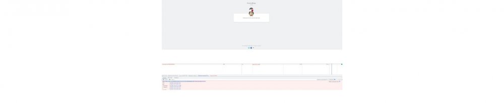

afsalthai Posted November 14, 2021 Author Share Posted November 14, 2021 Getting this error from Networks, note: my primary domain(ica.unx.bluehost.me) was changed couple of days before, now i use elegantkids.co.th (Thailand TLD) -- FatalThrowableError HTTP 500 Internal Server Error Type error: idn_to_utf8() expects parameter 3 to be int, string given Exception Symfony\Component\Debug\Exception\FatalThrowableError in src/Core/Util/InternationalizedDomainNameConverter.php (line 47) $parts = explode('@', $email); if (count($parts) !== 2) { return $email; } return $parts[0] . '@' . idn_to_utf8($parts[1], 0, INTL_IDNA_VARIANT_UTS46); } } idn_to_utf8('elegantkids.co.th', 0, 'INTL_IDNA_VARIANT_UTS46')in src/Core/Util/InternationalizedDomainNameConverter.php (line 47) $parts = explode('@', $email); if (count($parts) !== 2) { return $email; } return $parts[0] . '@' . idn_to_utf8($parts[1], 0, INTL_IDNA_VARIANT_UTS46); } } InternationalizedDomainNameConverter->emailToUtf8('[email protected]')in controllers/admin/AdminLoginController.php (line 205) public function processLogin() { /* Check fields validity */ $passwd = trim(Tools::getValue('passwd')); $email = $this->IDNConverter->emailToUtf8(trim(Tools::getValue('email'))); Hook::exec( 'actionAdminLoginControllerLoginBefore', [ 'controller' => $this, 'password' => $passwd, AdminLoginControllerCore->processLogin()in controllers/admin/AdminLoginController.php (line 191) 'controller' => $this, ] ); if (Tools::isSubmit('submitLogin')) { $this->processLogin(); } elseif (Tools::isSubmit('submitForgot')) { $this->processForgot(); } elseif (Tools::isSubmit('submitReset')) { $this->processReset(); } AdminLoginControllerCore->postProcess()in classes/controller/Controller.php (line 295) if (!$this->content_only && ($this->display_header || (isset($this->className) && $this->className))) { $this->setMedia(); } // postProcess handles ajaxProcess $this->postProcess(); if (!empty($this->redirect_after)) { $this->redirect(); } ControllerCore->run()in classes/Dispatcher.php (line 518) if (isset($params_hook_action_dispatcher)) { Hook::exec('actionDispatcher', $params_hook_action_dispatcher); } // Running controller $controller->run(); // Execute hook dispatcher after if (isset($params_hook_action_dispatcher)) { Hook::exec('actionDispatcherAfter', $params_hook_action_dispatcher); } DispatcherCore->dispatch()in admin876kjmtww/index.php (line 93) if (!headers_sent()) { header('Content-Type: text/html; charset=utf-8'); } // Prepare and trigger LEGACY admin dispatcher Dispatcher::getInstance()->dispatch(); } Logs 2 LevelChannelMessage INFO08:51:40phpUser Deprecated: Not specifying the optional ShopConstraint parameter is deprecated since version 1.7.8.0 INFO08:51:40phpUser Deprecated: Not specifying the optional ShopConstraint parameter is deprecated since version 1.7.8.0 INFO08:51:40phpUser Deprecated: Not specifying the optional ShopConstraint parameter is deprecated since version 1.7.8.0 INFO08:51:40phpUser Deprecated: Not specifying the optional ShopConstraint parameter is deprecated since version 1.7.8.0 INFO08:51:40phpUser Deprecated: Not specifying the optional ShopConstraint parameter is deprecated since version 1.7.8.0 INFO08:51:40phpUser Deprecated: Not specifying the optional ShopConstraint parameter is deprecated since version 1.7.8.0 CRITICAL08:51:40phpType error: idn_to_utf8() expects parameter 3 to be int, string given CRITICAL08:51:41requestUncaught PHP Exception Symfony\Component\Debug\Exception\FatalThrowableError: "Type error: idn_to_utf8() expects parameter 3 to be int, string given" at /home2/icaunxmy/public_html/src/Core/Util/InternationalizedDomainNameConverter.php line 47 Stack Trace FatalThrowableError Symfony\Component\Debug\Exception\FatalThrowableError: Type error: idn_to_utf8() expects parameter 3 to be int, string given at src/Core/Util/InternationalizedDomainNameConverter.php:47 at idn_to_utf8('elegantkids.co.th', 0, 'INTL_IDNA_VARIANT_UTS46') (src/Core/Util/InternationalizedDomainNameConverter.php:47) at PrestaShop\PrestaShop\Core\Util\InternationalizedDomainNameConverter->emailToUtf8('[email protected]') (controllers/admin/AdminLoginController.php:205) at AdminLoginControllerCore->processLogin() (controllers/admin/AdminLoginController.php:191) at AdminLoginControllerCore->postProcess() (classes/controller/Controller.php:295) at ControllerCore->run() (classes/Dispatcher.php:518) at DispatcherCore->dispatch() (admin876kjmtww/index.php:93) Link to comment Share on other sites More sharing options...
Rhobur Posted November 14, 2021 Share Posted November 14, 2021 It seems your ICU library is too old, ask your hosting to upgrade it or you upgrade it if you manage your server. Try with ICU version 58.2. PHP should be 7.3 or 7.4. Link to comment Share on other sites More sharing options...
afsalthai Posted November 14, 2021 Author Share Posted November 14, 2021 hosting provider updated php 7.3 and icu as per listed below but hosting says "ICU version is related with prestashop dashboard, prestashop is 3rd party, we recommend contacting prestashop support and update dashboard." can you recommend how i can solve this. Thank you so much Link to comment Share on other sites More sharing options...
Rhobur Posted November 14, 2021 Share Posted November 14, 2021 It should work but if it doesn't you could try as described below. Do this change in the file "src/Core/Util/InternationalizedDomainNameConverter.php". The constant INTL_IDNA_VARIANT_UTS46 needs to be converted to int type explicitelly by intval() on the line 47. If you have this line: return $parts[0] . '@' . idn_to_utf8($parts[1], 0, (INTL_IDNA_VARIANT_UTS46)); Change it to this: return $parts[0] . '@' . idn_to_utf8($parts[1], 0, intval(INTL_IDNA_VARIANT_UTS46)); 1 Link to comment Share on other sites More sharing options...
