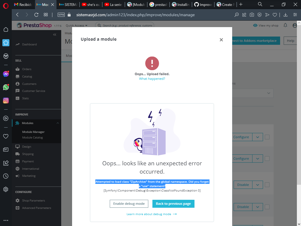

MarcotheCat Posted October 19, 2021 Share Posted October 19, 2021 Greetings, when I want to install a module zip file I get an error and I don't know how to fix it, please, can you tell me what I can do? Thanks. I'll attach a screenshot of the error. Link to comment Share on other sites More sharing options...

MarcotheCat Posted October 20, 2021 Author Share Posted October 20, 2021 23 minutes ago, Nickz said: You should ask the developer first: Contact them here Solved, the problem was that the zip extension wasn't enable on the server, I solved it entering on it in the CPanel and I enable it, thanks anyway. Link to comment Share on other sites More sharing options...
