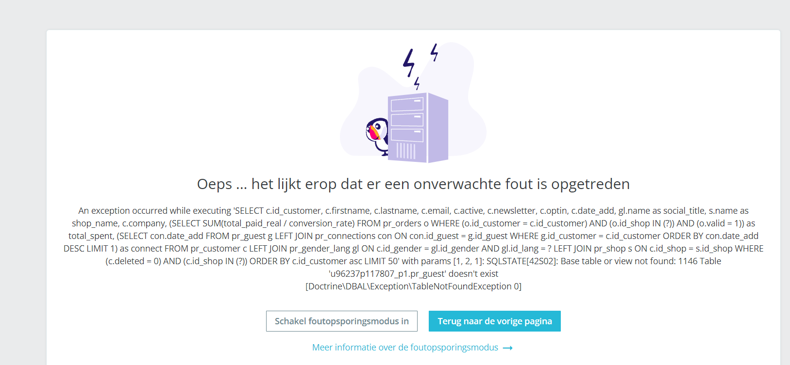

I'm working with Prestashop for about 7 months now and never expierenced problems. After deciding to update tonight, which i regret deeply, i am encountering two errors. After updating my font changed to something completely different and blocks were missing on the homepage. So i decided to roll back. After rolling back i can't go to the page ''Customers'' anymore. It is giving me a fatal error:
And the second error:

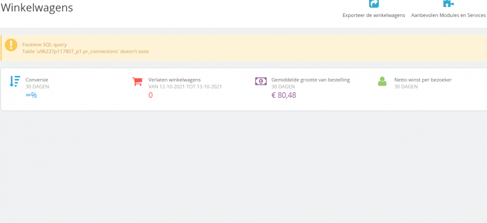

When i try to reach ''Active Carts'' it gives me this problem:
Table 'u96237p117807_p1.pr_connections' doesn't exist
