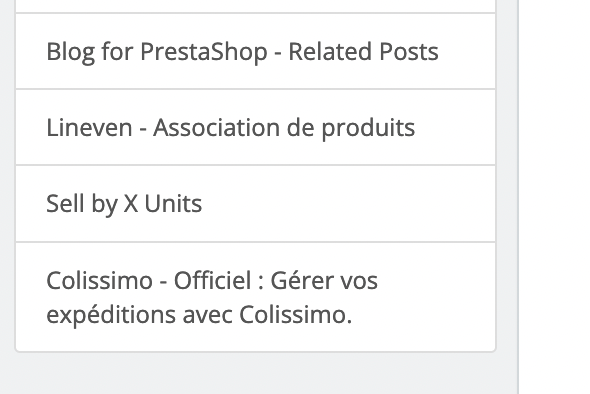

Imaginis Posted January 20, 2022 Share Posted January 20, 2022 (edited) Thanks for you reply. Can the fact that there are third-party modules in the products BO of the 1.6 source shop explain this problem (see attached image)? How can I actually solve the problem in the destination shop? Edited January 20, 2022 by Imaginis (see edit history) Link to comment Share on other sites More sharing options...
Imaginis Posted January 20, 2022 Share Posted January 20, 2022 I'm doing a data migration (with MigrationPro module) between 1.6.1.24 and 1.7.8.2 Link to comment Share on other sites More sharing options...

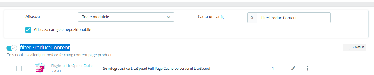

Imaginis Posted January 20, 2022 Share Posted January 20, 2022 (edited) I found the source of the problem: the LiteSpeed Cache Module (even when disabled) who is no more compatible with Alysum theme... https://support.promokit.eu/index.php?do=details&task_id=22221&project=0&order=dateopened&sort=desc&order2=assignedto&sort2=asc Edited January 20, 2022 by Imaginis (see edit history) 1 Link to comment Share on other sites More sharing options...

apollux Posted October 6, 2023 Share Posted October 6, 2023 On 1/20/2022 at 4:34 PM, Imaginis said: I found the source of the problem: the LiteSpeed Cache Module (even when disabled) who is no more compatible with Alysum theme... https://support.promokit.eu/index.php?do=details&task_id=22221&project=0&order=dateopened&sort=desc&order2=assignedto&sort2=asc Expand On 1/20/2022 at 10:18 AM, Imaginis said: Hello, Did you find a solution to this problem? I am exactly in the same situation after an important data migration (around 9000 products) from Prestashop 1.6.1.24 to 1.7.8.2 (clean install) with the MigrationPro module. I have a blank page when I open a product page on front and in debug mode I have the following error (see also capture herewith) : (1/1) FatalThrowableError Type error: Argument 3 passed to HookCore::callHookOn() must be of the type array, null given, called in /home/test/test/classes/Hook.php on line 934 in Hook.php line 412 at HookCore::callHookOn(object(LiteSpeedCache), 'filterProductContent', null)in Hook.php line 934 at HookCore::exec('filterProductContent', null, null, false, true, false, null, true)in ProductController.php line 384 at ProductControllerCore->initContent()in Controller.php line 306 at ControllerCore->run()in Dispatcher.php line 518 at DispatcherCore->dispatch()in index.php line 28 With the difference that I can save the product sheets. The problem also occurs if I create a new product. Thanks in advance for any help ! Expand Both issues are caused in the filterProductContent hook instance. For example, in filterProductContent you might have two conflicting modules. Litespeed should be the first one to be connected to since you want to parse cache, the second one might be comments or anything else. We've mainly saw for our clients modules that were not following Prestashop components and thus not working correctly. So, to fix that: 1. Go to Design Positions, move the Litespeed on the first line. 2. Clear cache both sides, Prestashop and Litedspeed and try again. If the problem persists, then try removing one of the modules that were before Litespeed. Link to comment Share on other sites More sharing options...
