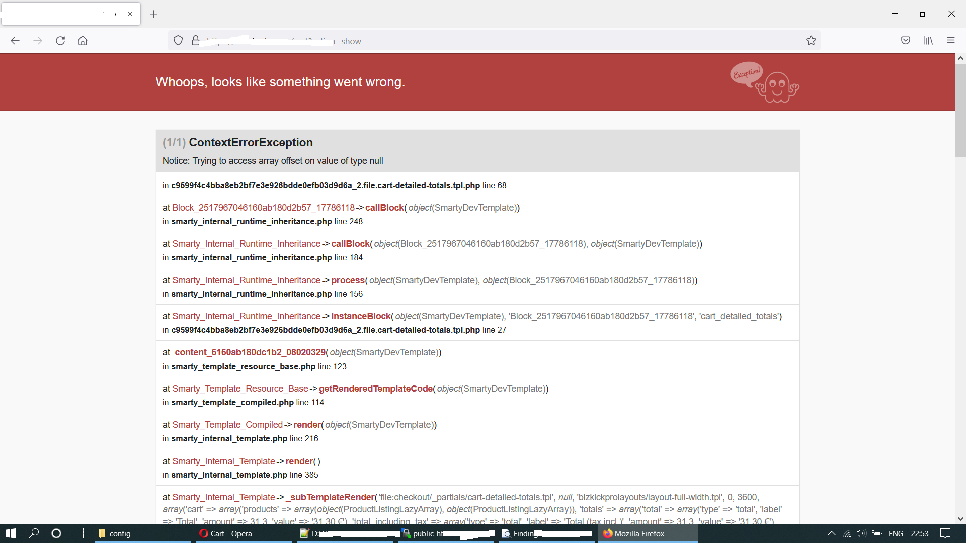

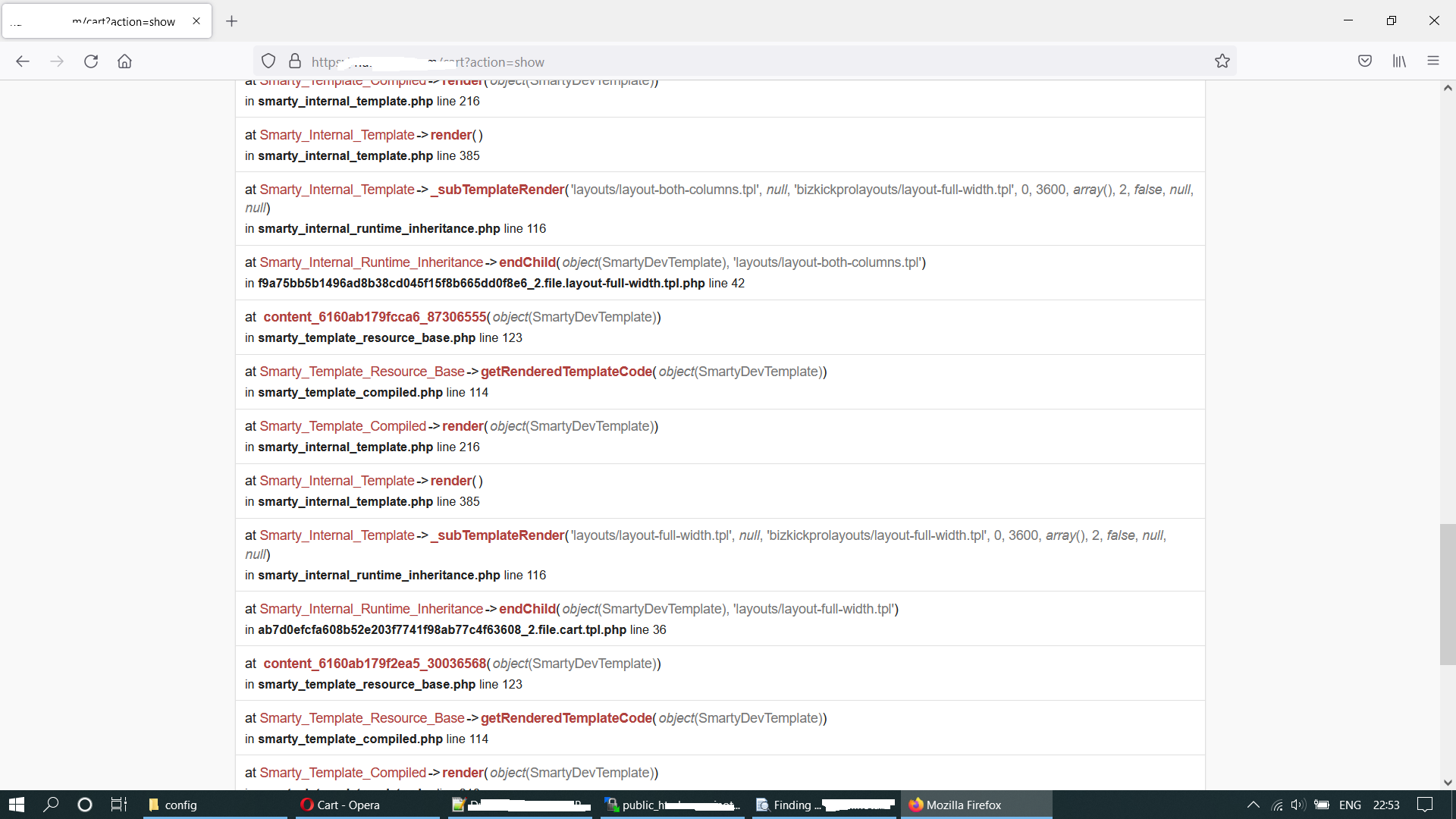

After upgrade not working shopping cart.
First when upgrade to 1.7.8 and PHP 7.3 at shopping cart not working ajax update on products quantities and delete not working.
When change to PHP 7.4 error in shopping cart: Notice: Trying to access array offset on value of type null
First issue I think with jquery. Second need check if is set index.
But I don't know where fix it.
Or it is theme problem or core?
Any ideas?

With theme classic everything work.
Some problems i fixed, but more and more problems.
My theme not ready for work with PHP 7.4, and after update from PS 1.7.7.8 to 1.7.8.0 something changes in JS so not working auto refresh in shopping cart.
So probably I will rollback to previous version.. :(
I Will Try contact with theme creator, maybe soon will be theme update. iF no, then will use old PS..
