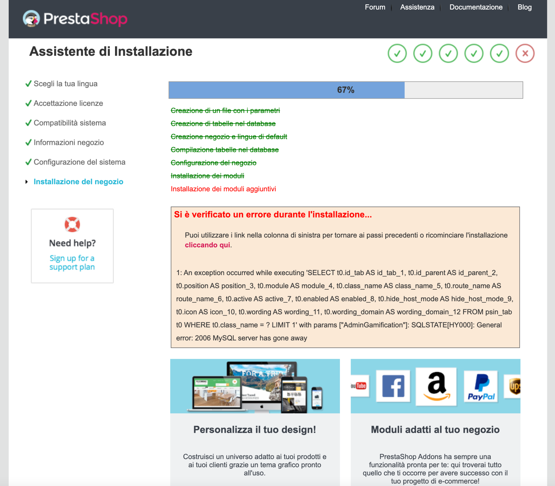

SimoneMessina Posted October 7, 2021 Share Posted October 7, 2021 al 67% in fase di installazione moduli aggiuntivi provato sia con prestahop 1.7.7.8 stable che con 1.7.8 stable ricevo il seguente errore Si è verificato un errore durante l'installazione... Puoi utilizzare i link nella colonna di sinistra per tornare ai passi precedenti o ricominciare l'installazione cliccando qui. 1: An exception occurred while executing 'SELECT t0.id_tab AS id_tab_1, t0.id_parent AS id_parent_2, t0.position AS position_3, t0.module AS module_4, t0.class_name AS class_name_5, t0.route_name AS route_name_6, t0.active AS active_7, t0.enabled AS enabled_8, t0.hide_host_mode AS hide_host_mode_9, t0.icon AS icon_10, t0.wording AS wording_11, t0.wording_domain AS wording_domain_12 FROM psin_tab t0 WHERE t0.class_name = ? LIMIT 1' with params ["AdminGamification"]: SQLSTATE[HY000]: General error: 2006 MySQL server has gone away. Qualche suggerimento su come risolvere? Ho già provato a modificare vari parametri del server in configurazione PHP Link to comment Share on other sites More sharing options...
ziobudda Posted October 7, 2021 Share Posted October 7, 2021 Ciao, solitamente questo problema avviene quando MySQL diventa così lento da smettere di funzionare e quindi andare in errore. Contatta il tuo provider e faglielo presente. M. Link to comment Share on other sites More sharing options...
nunoweb Posted November 13, 2021 Share Posted November 13, 2021 (edited) Helo I have the same problem. The problem is the server memory off mysql. I resolve this problem to intall wampserver in my pc and intall de prestashop local. install ok no errors and run ok no problems. Next ftp all files to server an export DB local and uploud in server change the conection and all is ok. Edited November 13, 2021 by nunoweb (see edit history) Link to comment Share on other sites More sharing options...
