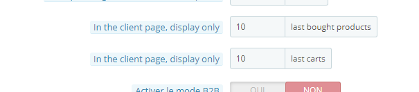

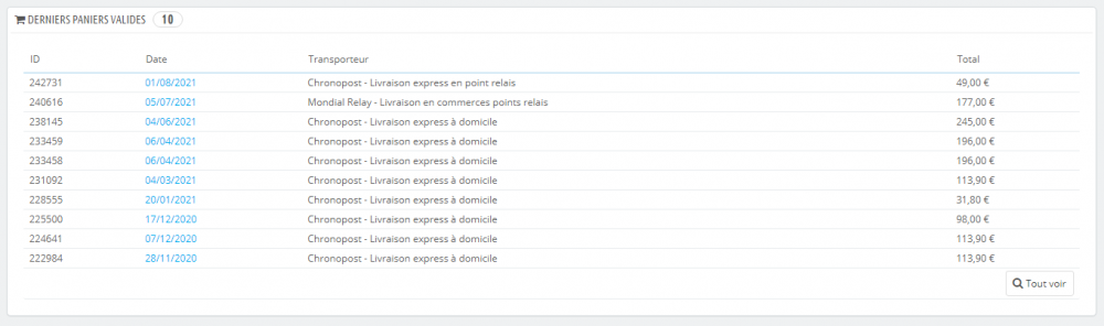

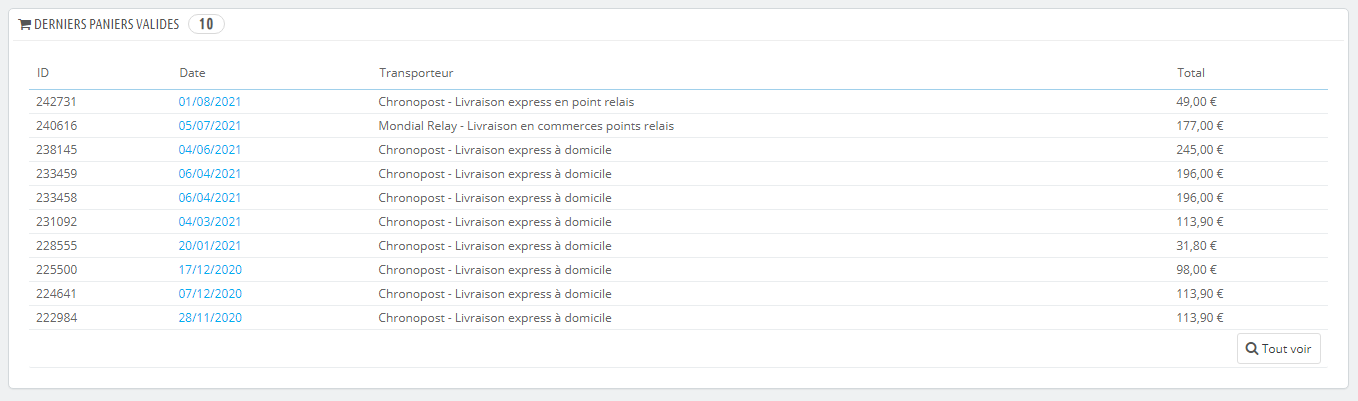

Eolia Posted September 8, 2021 Share Posted September 8, 2021 Ou ça: Link to comment Share on other sites More sharing options...
