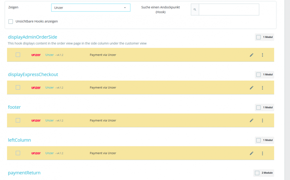

waldgeist Posted August 27, 2021 Share Posted August 27, 2021 Hi, im using Prestashop 1.7.7. with "Ap PageBuilder" modul and "At Gucci Version 4.0.7" template. Now I have installed a payment provider module (from unzer) - I activated it too. But the payment options (from the modul) are not displayed in the frontend-shop (in the ordering process on the payment page). In "Design">"Position" the module is shown correct. It is possible that the theme doesn't supports the payment module? Please help. Thanks and Regards Martin Link to comment Share on other sites More sharing options...

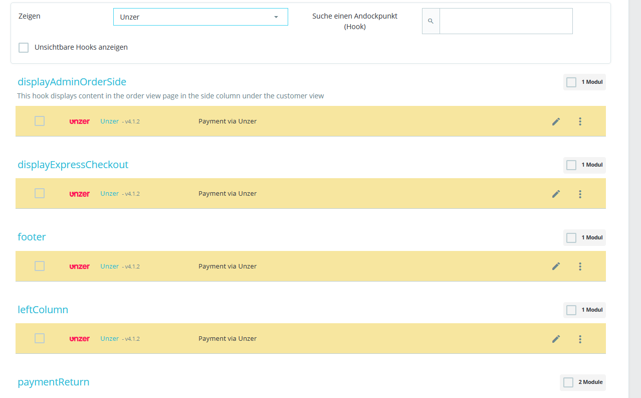

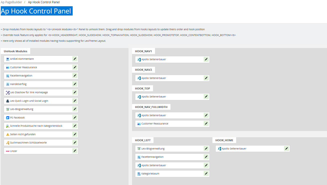

waldgeist Posted September 1, 2021 Author Share Posted September 1, 2021 Hi, the "Unzer-Modul" is up-to-date. I also installed the "Bank Transfer" module - and that is displayed correctly on the frontend. And I think the hook is also correct ... see attachement But I don't know if the "Ap PageBuilder" is using its own hook ... because there exits a "Ap Hook Control Panel" ... see attachement (there I can also find the unzer Module). Please help! Link to comment Share on other sites More sharing options...
