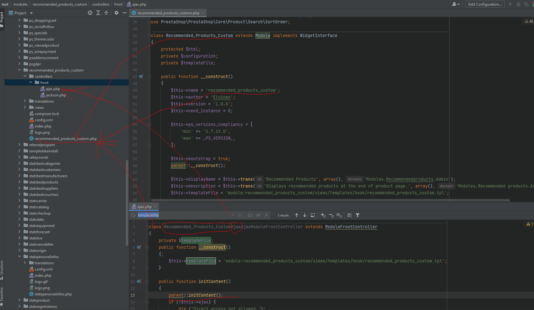

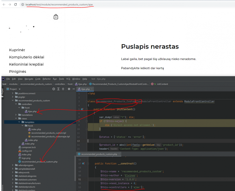

Elvinas Posted August 26, 2021 Share Posted August 26, 2021 (edited) So, here's is my custom module that I created. Please see attached. So I have a problem where ModuleFrontController is not accessible it gives me 404 when I try to access it, using this url, that I generated with this code: $this->context->link->getModuleLink($this->name, 'ajax'); It returns this url: http://localhost/test/module/recommended_products_custom/ajax When I visit it, it returns 404, I changed my module's folder name and class and module name, you can see the current structure in the image. And it is strange. It no longer works, could anyone please tell me if I made a mistake renaming, as I don't see it myself and I really feel like I'm following the right naming conventions. Any help is really appreciated. Edited August 26, 2021 by Elvinas (see edit history) Link to comment Share on other sites More sharing options...

Elvinas Posted August 26, 2021 Author Share Posted August 26, 2021 (edited) 31 minutes ago, endriu107 said: You need to register controllers by $this->controllers = array('ajax'); Unfortunately it did nothing. Seems really weird, impossible to identify what is wrong. It seems that folder names, module name, and class names are all correctly named. Edited August 26, 2021 by Elvinas (see edit history) Link to comment Share on other sites More sharing options...

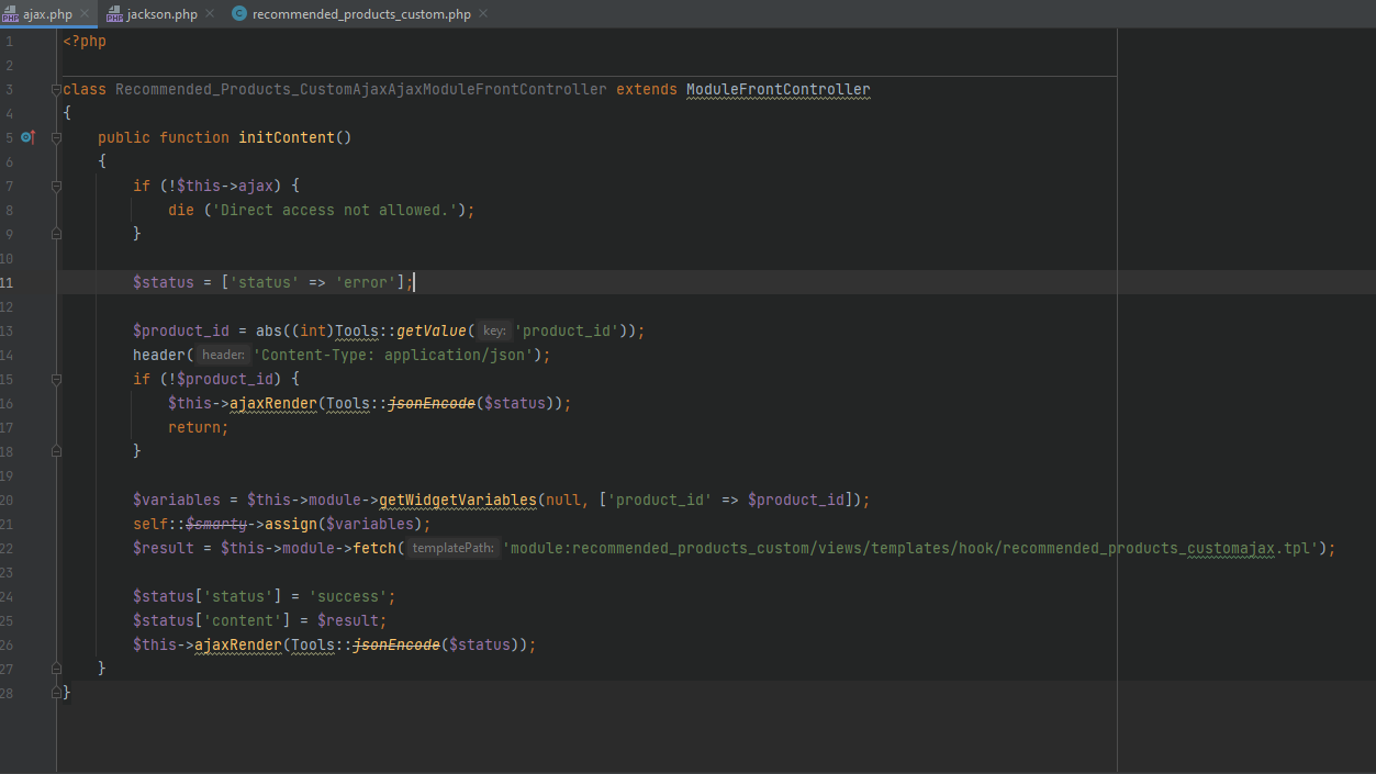

Elvinas Posted August 26, 2021 Author Share Posted August 26, 2021 11 minutes ago, endriu107 said: In initContent did you set template path? Yes, I did. Please see attached. I think the problem is probably somewhere else, but regardless it is really weird. Because personally I'm not sure if the template path could be related somehow, as I tried to echo out some text at the very beginning of initContent() function and still I got 404 error, so it happens even before the template is fetched. Link to comment Share on other sites More sharing options...

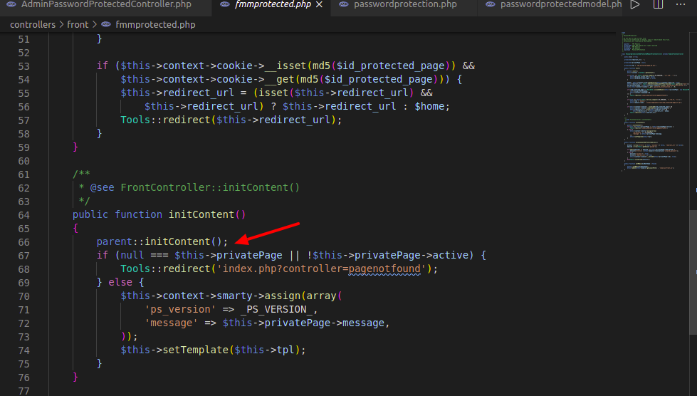

Shabab Posted August 26, 2021 Share Posted August 26, 2021 Just now, Elvinas said: Yes, I did. Please see attached. I think the problem is probably somewhere else, but regardless it is really weird. Because personally I'm not sure if the template path could be related somehow, as I tried to echo out some text at the very beginning of initContent() function and still I got 404 error, so it happens even before the template is fetched. Please call parent::initContent(); in your initContent function Link to comment Share on other sites More sharing options...
Shabab Posted August 26, 2021 Share Posted August 26, 2021 Call like this Link to comment Share on other sites More sharing options...

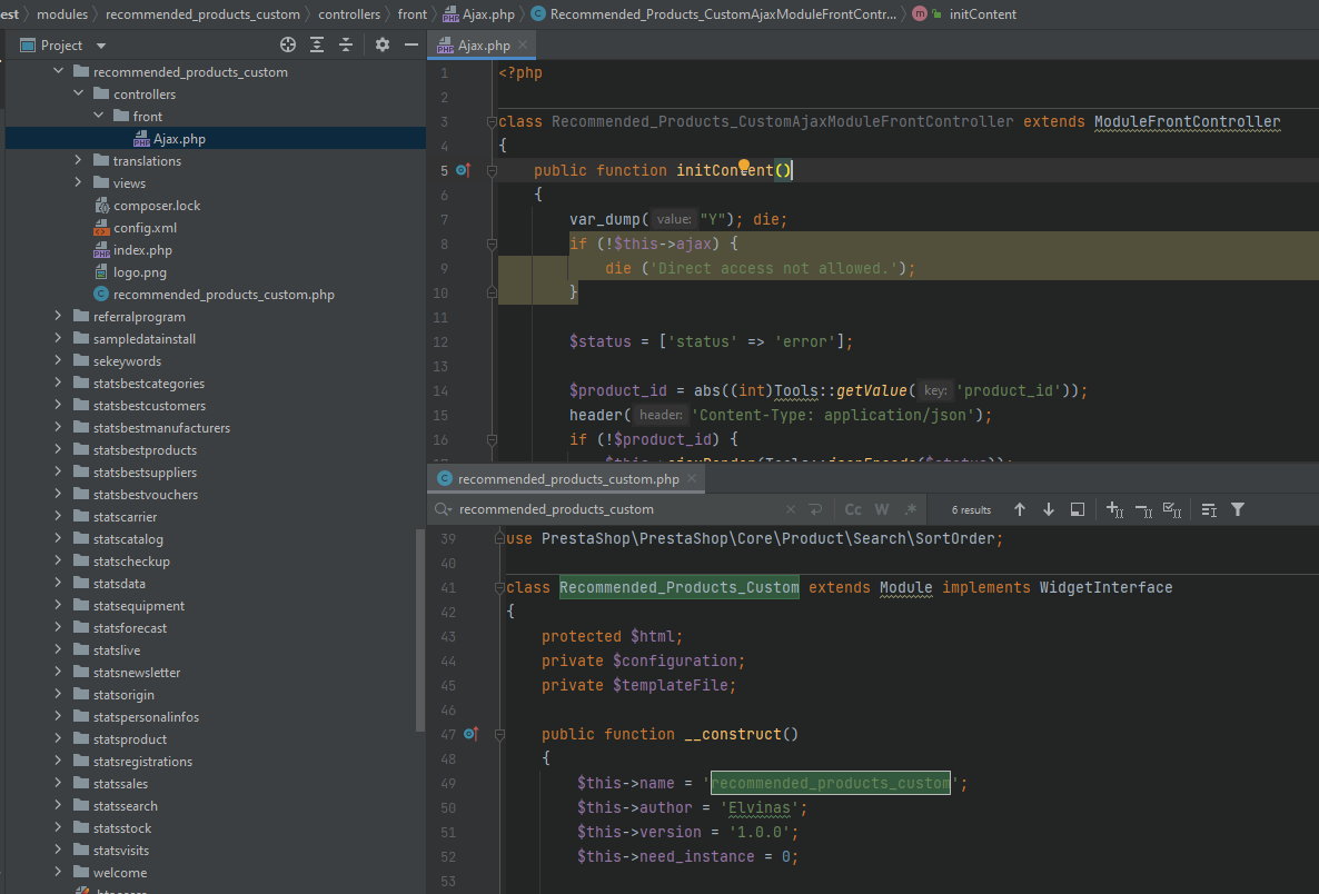

Elvinas Posted August 26, 2021 Author Share Posted August 26, 2021 (edited) I uploaded an image, please see attached. So my module's folder name is: 'recommended_products_custom The main module's file name is: recommended_products_custom.php (the same as folder name + .php) The main module's file class name is: Recommended_Products_Custom The front controller file name is: ajax.php and class name: Recommended_Products_CustomAjaxAjaxModuleFrontController when it should have been Recommended_Products_CustomAjaxModuleFrontController (only one Ajax word). And to my surprise it still does not work. Even after addint parent::initContent(); and such. Looks like I found the naming problem and it still didn't solve this, just wow. Thanks guys for trying to help me Edited August 26, 2021 by Elvinas (see edit history) Link to comment Share on other sites More sharing options...
