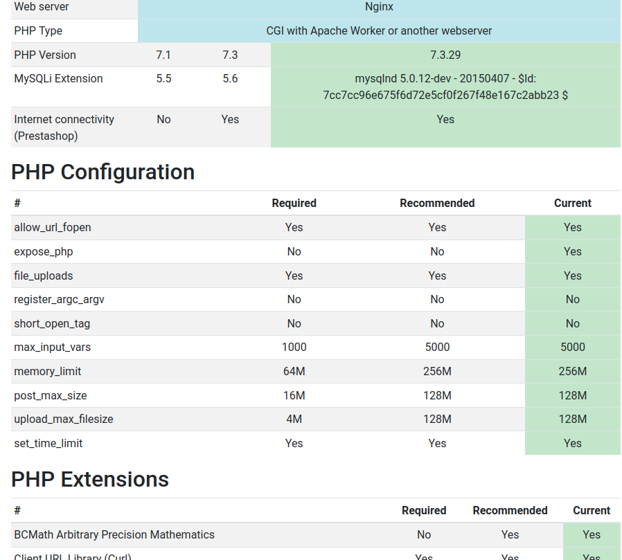

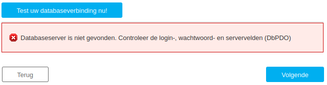

Ofloo Posted August 18, 2021 Share Posted August 18, 2021 Started out with php8 but that i think has it's own problems, so changed to php7.4. When I run phppsinfo.php all is green except the first 2 those are blue, seems normal to me though. webserver: nginx -V nginx version: nginx/1.20.1 built with OpenSSL 1.1.1k-freebsd 25 Mar 2021 TLS SNI support enabled php version PHP 7.4.22 (cli) (built: Aug 3 2021 01:11:05) ( NTS ) Copyright (c) The PHP Group Zend Engine v3.4.0, Copyright (c) Zend Technologies with Zend OPcache v7.4.22, Copyright (c), by Zend Technologies Prestashop version 1.7.7.6 mysql version: mysql -V mysql Ver 8.0.25 for FreeBSD13.0 on amd64 (Source distribution) I can login with the created user on mysql database from console, the entered database information is correct. Tried both firefox and chromium-browser Error translated says database server not found, check login and password fields. I can see an active connection on the database server, although not sure if it authenticated properly. Not sure where to check for authentication errors in mysql, however when I check err log can't see any issues. Complete new installed server/services. Link to comment Share on other sites More sharing options...

Ofloo Posted August 22, 2021 Author Share Posted August 22, 2021 Yes I've created a database. But if it's such an issue to go beyond php version 7.3 then maybe this should be a disclaimer, 7.1+ <=7.3 because 7.1+ is everything above. however !! And still the same problem. And yes the mysql db just works. There's no doubt I can login on the console using the same credentials ! The database server is installed locally so nginx is connecting from localhost. There's no authentication issue. I created both user shop@localhost and [email protected]. # mysql -u shop -p db_shop_0 Enter password: Welcome to the MySQL monitor. Commands end with ; or \g. Your MySQL connection id is 227 Server version: 8.0.25 Source distribution Copyright (c) 2000, 2021, Oracle and/or its affiliates. Oracle is a registered trademark of Oracle Corporation and/or its affiliates. Other names may be trademarks of their respective owners. Type 'help;' or '\h' for help. Type '\c' to clear the current input statement. shop@localhost [db_shop_0]> Link to comment Share on other sites More sharing options...
Nickz Posted August 22, 2021 Share Posted August 22, 2021 What is the path to the DB? Change the parameter if you copy them for publishing purposes. Do not openly publish here the real data. If unsure PM me. Link to comment Share on other sites More sharing options...
Ofloo Posted August 26, 2021 Author Share Posted August 26, 2021 Path? the files are handled by mysql, .. why would you want to know the path of the database? Or did you mean path to mysql.sock. For the sake of simplicity I've chosen to use port 3306, .. about that real data there isn't anything critical or problematic up there. 1 Link to comment Share on other sites More sharing options...
