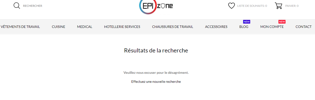

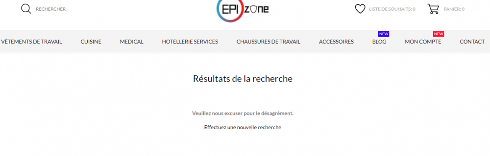

EPIZONE Posted August 16, 2021 Author Share Posted August 16, 2021 On 8/14/2021 at 4:51 PM, ComGrafPL said: Can you describe "malfunction". As for me, it looks fine. Search bar not working, either not searching properly? Not working (see img) Link to comment Share on other sites More sharing options...

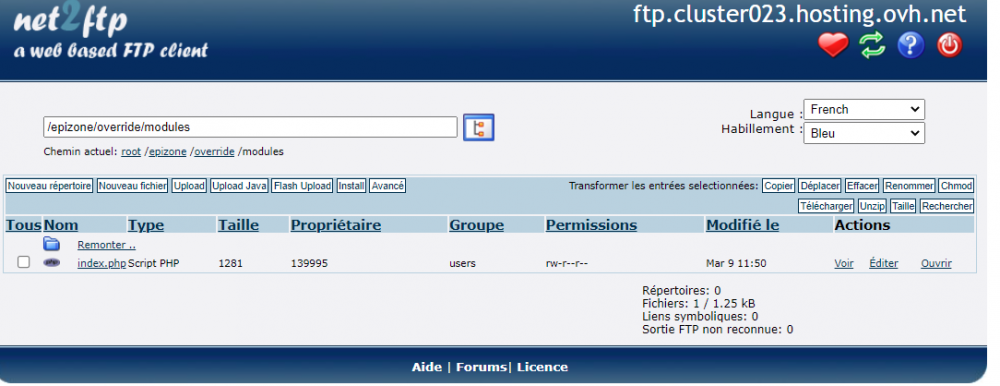

musicmaster Posted August 27, 2021 Share Posted August 27, 2021 55 minutes ago, EPIZONE said: PS Version is 1.7.5.2 PHP Version is 7.3 The problem was here before jolisearch too. I'm going to delete him from FTP server. Did you check for overrides? You can do it by looking under the /override directory or with Prestools. Link to comment Share on other sites More sharing options...
EPIZONE Posted August 27, 2021 Author Share Posted August 27, 2021 Link to comment Share on other sites More sharing options...
musicmaster Posted August 27, 2021 Share Posted August 27, 2021 1 hour ago, EPIZONE said: It looks like you don't understand overrides. Overrides replaces existing files either partially of totally. So you might for example have a file /override/classes/search.php overriding /classes/search.php Link to comment Share on other sites More sharing options...
EPIZONE Posted August 27, 2021 Author Share Posted August 27, 2021 17 minutes ago, musicmaster said: It looks like you don't understand overrides. Overrides replaces existing files either partially of totally. So you might for example have a file /override/classes/search.php overriding /classes/search.php How do I know if I have overrides ? Link to comment Share on other sites More sharing options...
musicmaster Posted August 27, 2021 Share Posted August 27, 2021 Looking in the directories - as I indicated. Or using a tool like Prestools. Link to comment Share on other sites More sharing options...
