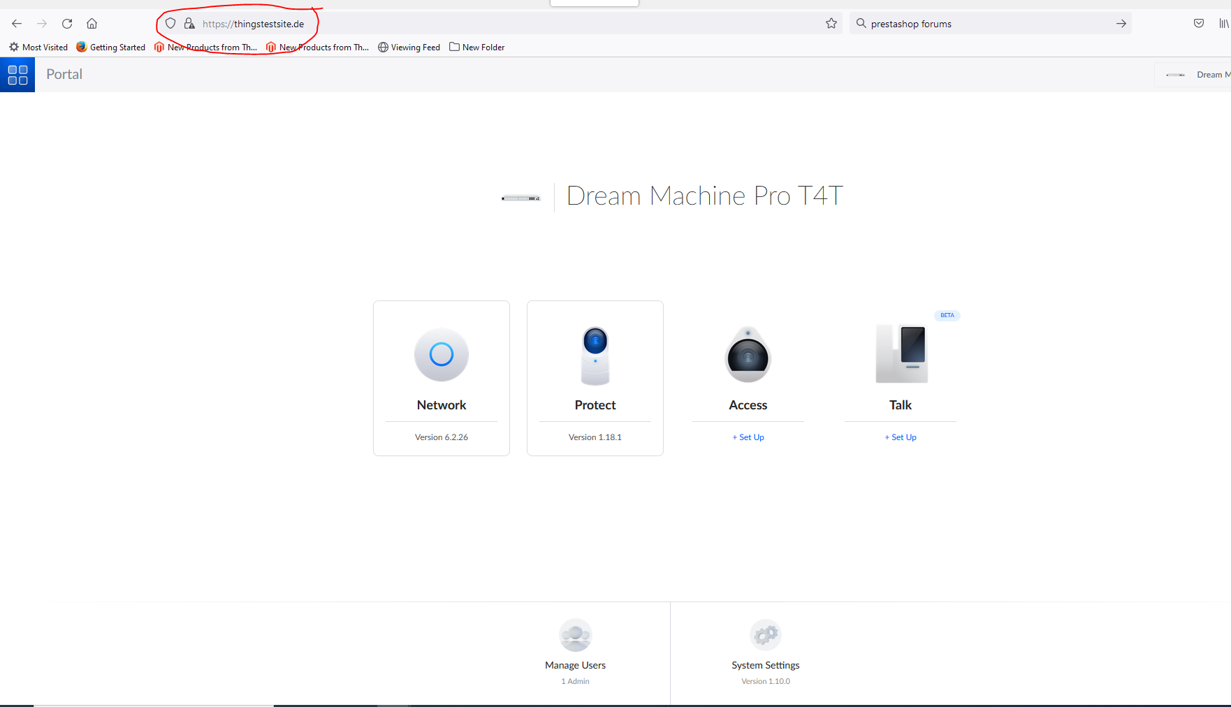

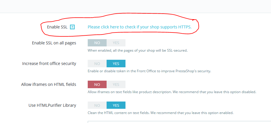

falken76 Posted August 11, 2021 Share Posted August 11, 2021 How do I fix this issue? I need an SSL on this site. Nobody will buy from ecommerce site without ssl and my crappy ISP blocks inbound on port 80 but not 443. I don't have an enable button, instead I have this link that says to check and see if my shop supports https. If I click that link it opens my URL on port 443 because it's going to https:// but it brings up my router. Why is it doing this? Why isn't there an enable button there so I can just configure this? I know this expensive Ubiquity router can do SSL If I try to forward port 443 it can't connect. Why is this so difficult? All I want to do is add the SSL to the website. I'm on Presta 1.7.7.5, I have PHP 7.4 installed. I have this installed on a dedicated server running Ubuntu 18.04 and the router is an Ubiquity Dream Machine Pro Link to comment Share on other sites More sharing options...
falken76 Posted August 12, 2021 Author Share Posted August 12, 2021 Is there a way to open a support ticket? I've got everything ready, but I can not enable SSL so I can't make the site go live. Why is it giving a link that says "See if your shop supports SSL" instead of "Enable SSL"? I have a $400 poor mans enterprise router, I know it can do SSL. I need help with this, and no support can not get into my system because my ISP blocks ports like 80 but not 443 so I need this enabled for support to even log into my server, but at that point I would no longer need their assistance. Why is that link re-directing to my router instead of going wherever it's supposed to go? Link to comment Share on other sites More sharing options...
SmartDataSoft Posted August 12, 2021 Share Posted August 12, 2021 @falken76 The ssl is not handle by your local router. Your hosting need ssl enable , is your hosting is c panel based or other system for linux. you need to enable the ssl in your hosting first then you can enable this option. hope you understand. If you give me your site access in pm i am able to check and give you a solution Thank you Link to comment Share on other sites More sharing options...

falken76 Posted August 12, 2021 Author Share Posted August 12, 2021 Thank you so much. I'm using VestaCP and I found where to put the SSL information. I'm very clueless when it comes to this stuff, my friend gave me some rack server his work was going to toss out, so it's running out of my house and I can't call a hosting company for help. My ISP doesn't want anyone running any webservers on port 80 so they block it entirely. I don't know how you would access my server since my ISP blocks inbound http's default port. I know how to forward ports on the router, but no clue how to configure apache2 or nginx to listen on certain ports. If the SSL can be added now, Https should take everyone to port 443 and it should work. Now I'm trying to get a free test SSL but I'm having trouble proving I own the server because my ISP also blocks port 25 for SMTP and it blocks IMAP also. I need to sort that out elsewhere. Thank you so much for the help. Link to comment Share on other sites More sharing options...
