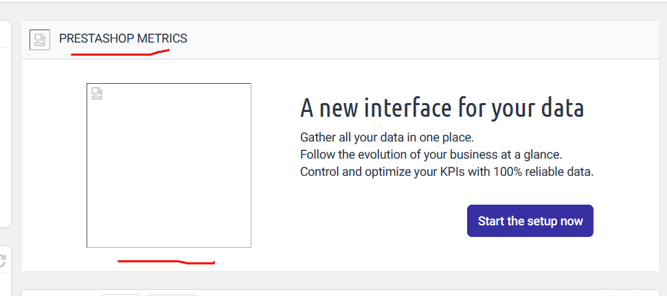

james Posted August 10, 2021 Share Posted August 10, 2021 I have installed Prestashop 1.7.7.6 on one of my test servers with PHP 7.1 and Mysql 5.6 However I am facing an issue post logging into the admin panel. There is a widget sort of thing called "PrestaShop Metrics" which fails to load it's image.(please refer image) On debugging I found it's loading image from "/modules/ps_metrics/views/assets/logo-ps-metrics.7e5c2dc7.png" which is present at the location. However when you install prestashop in a sub directory this still searches the image in "/modules/ps_metrics/views/assets/logo-ps-metrics.7e5c2dc7.png" which is I guess wrong. It should search in "/[[subdirectory]]/modules/ps_metrics/views/assets/logo-ps-metrics.7e5c2dc7.png" What could be the solution for this ? Link to comment Share on other sites More sharing options...
Inform-All Posted August 10, 2021 Share Posted August 10, 2021 Usually the image is linked according to the module requesting it. So this should not be the problem. Check (with FTP) if the permissions of the image(s) are correct. Link to comment Share on other sites More sharing options...
