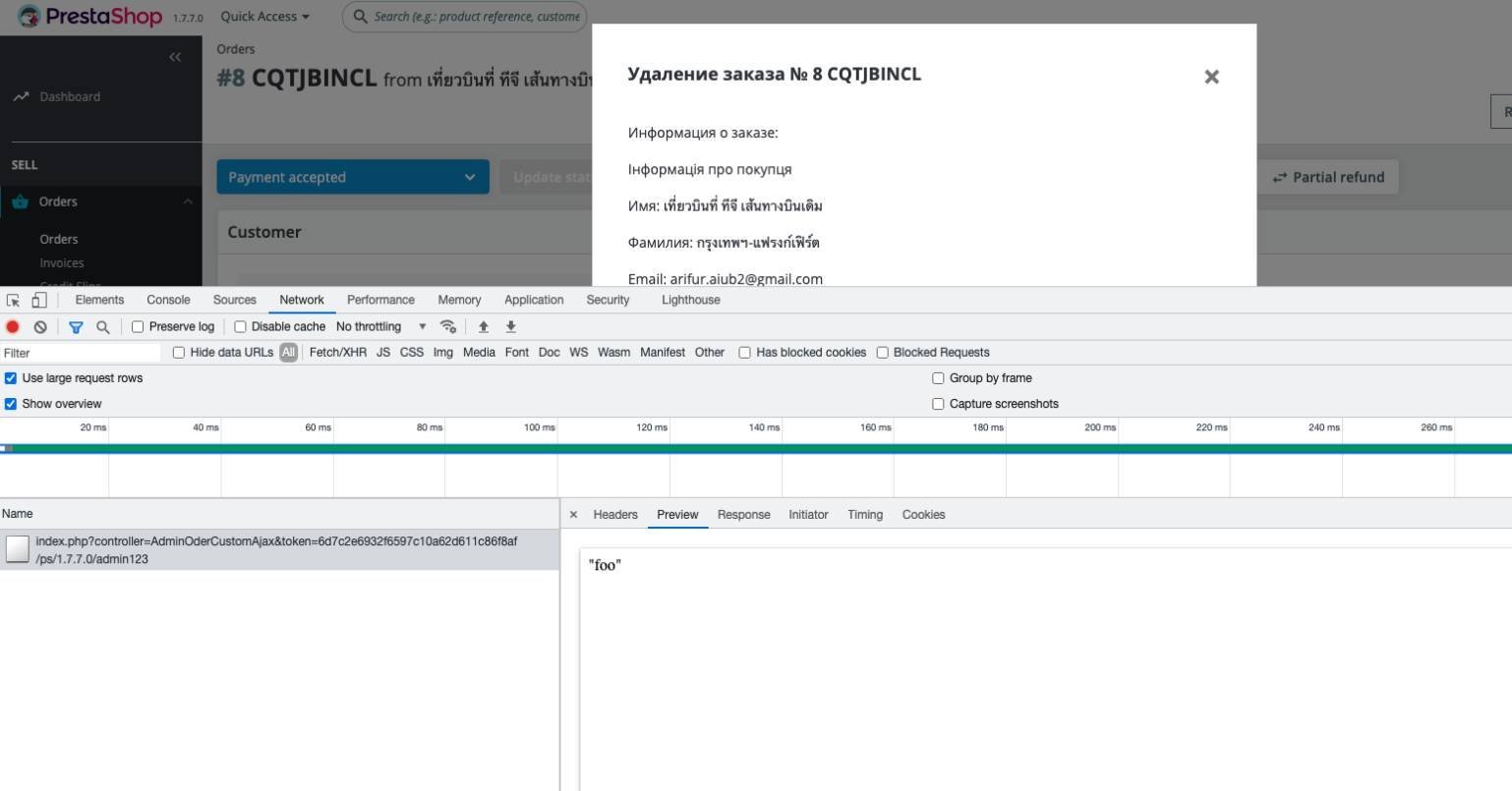

SmartDataSoft Posted August 10, 2021 Share Posted August 10, 2021 @Motchanyy For you have add the code what is for adjust here is the final output. with image Do not forget to send me the final module when done vai PM Thank you deleteorders.zip Link to comment Share on other sites More sharing options...

SmartDataSoft Posted August 10, 2021 Share Posted August 10, 2021 Hello, you can check the code this function is used to create a hidden tab for the admin controller which locate in controllers/admin In my end it work. Because I have run this function from constructor without uninstall and then comment .and all work fine . Thank you Link to comment Share on other sites More sharing options...
