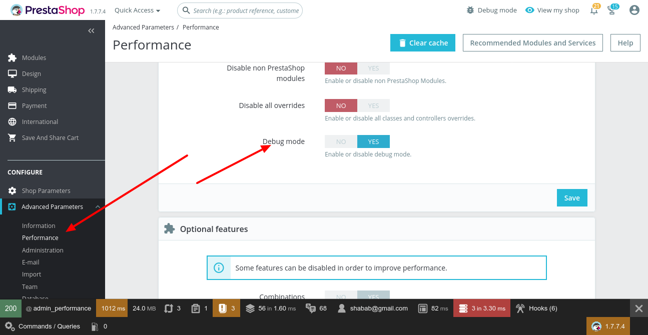

Shabab Posted August 6, 2021 Share Posted August 6, 2021 On 8/5/2021 at 3:49 AM, Raul Pimentel said: Thank you for your answer. I went trough all the menus and didn´t find option for that. I don´t have programming knowledge. Should I pay for prestashop help or the hosting provider can help me? You can enable debug mode here. Link to comment Share on other sites More sharing options...

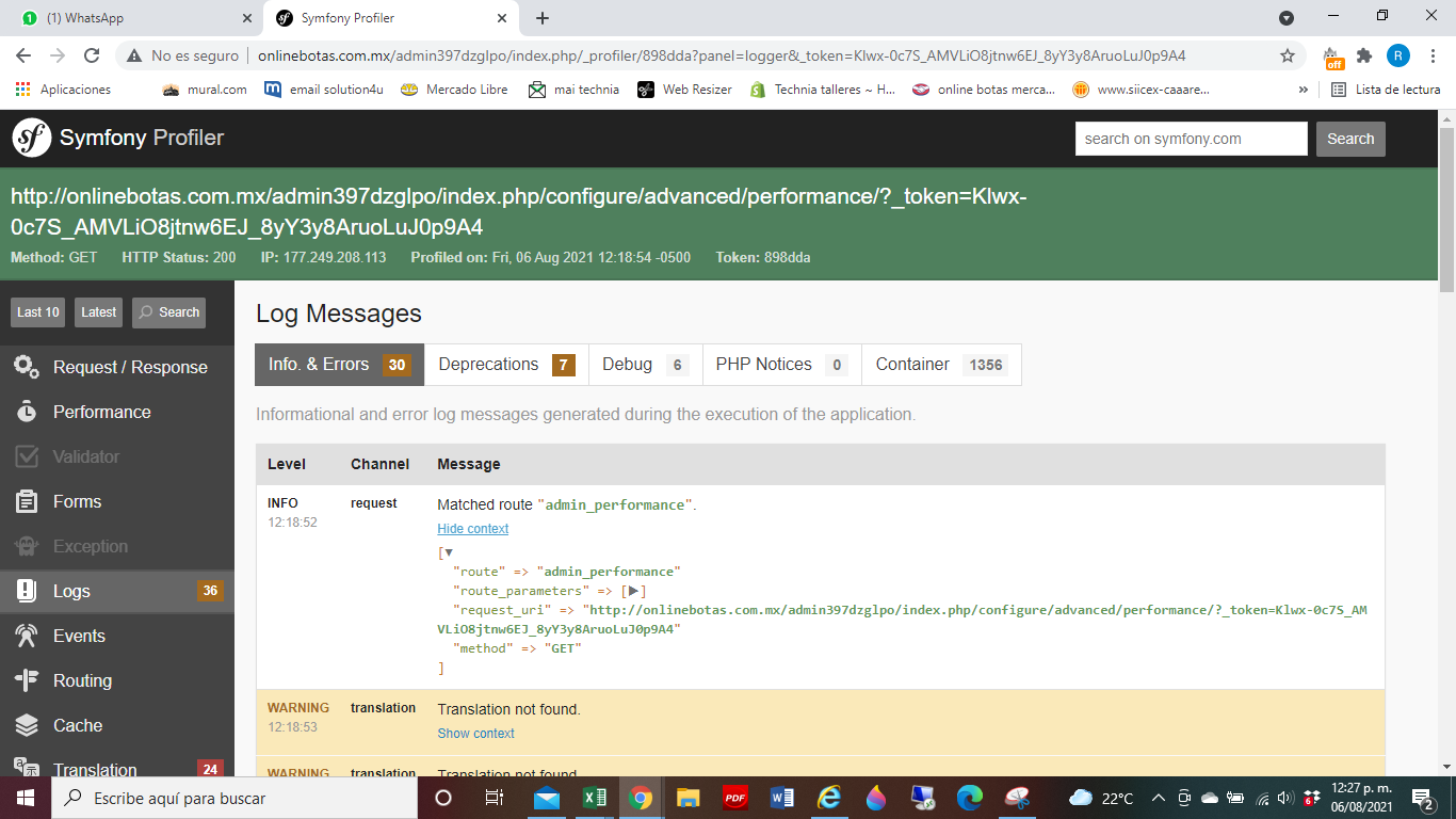

Raul Pimentel Posted August 6, 2021 Author Share Posted August 6, 2021 12 hours ago, uzishabab said: You can enable debug mode here. Link to comment Share on other sites More sharing options...
Raul Pimentel Posted August 6, 2021 Author Share Posted August 6, 2021 12 hours ago, uzishabab said: You can enable debug mode here. all others are translation issues Link to comment Share on other sites More sharing options...

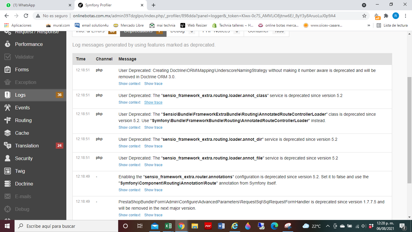

Raul Pimentel Posted August 6, 2021 Author Share Posted August 6, 2021 8 minutes ago, Raul Pimentel said: These are deprecations Link to comment Share on other sites More sharing options...
