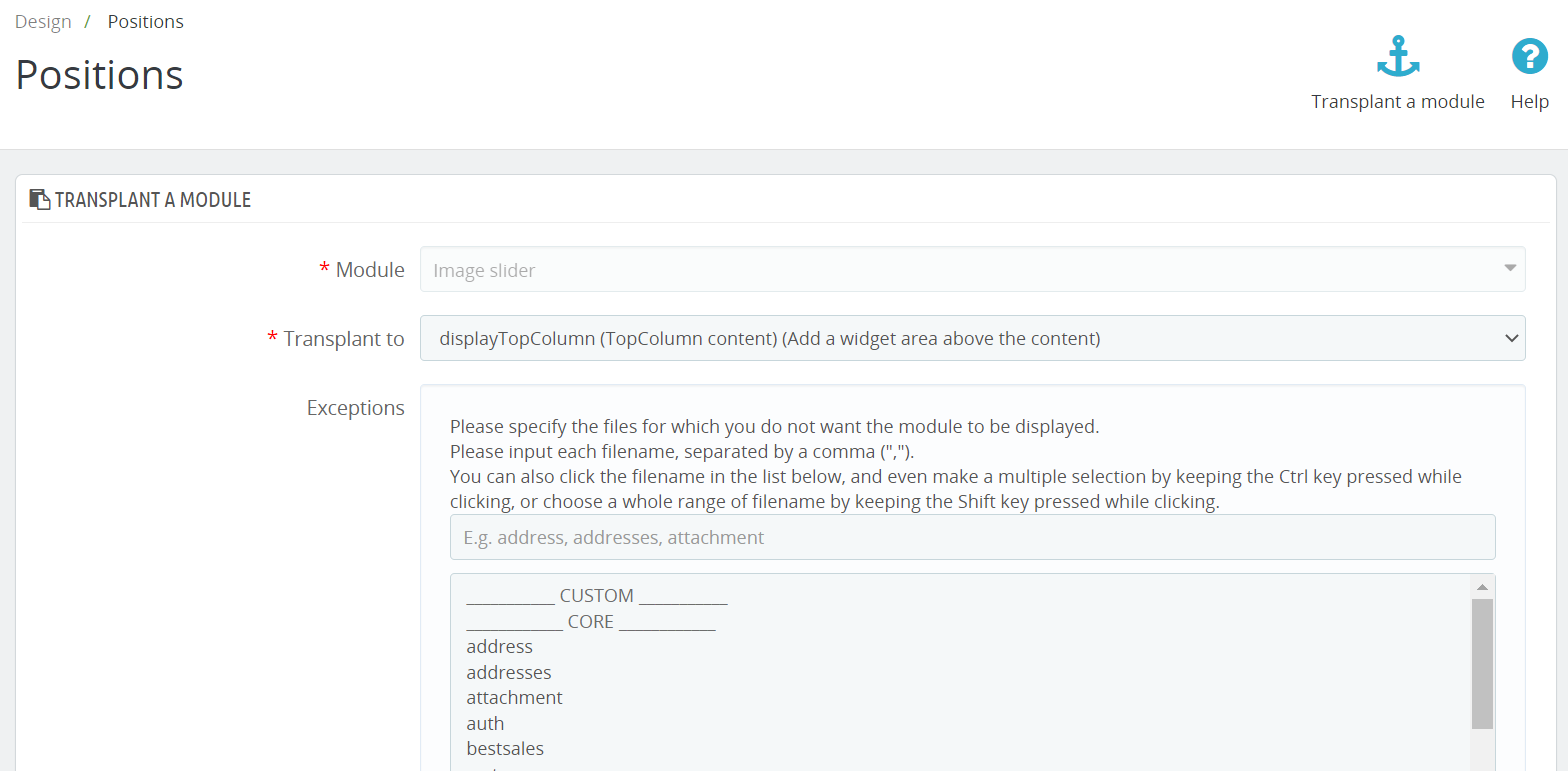

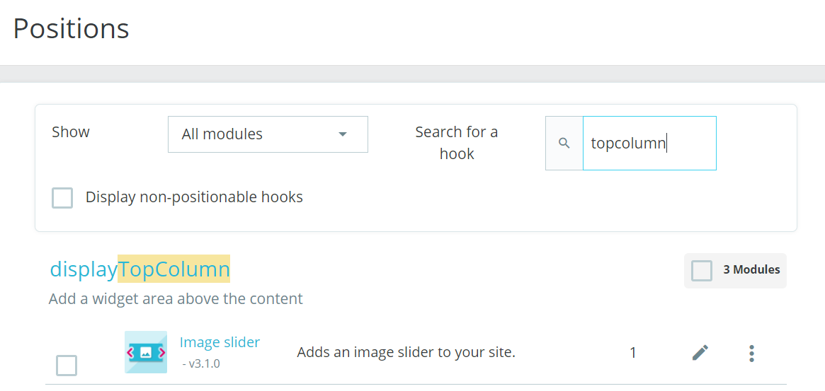

SmartDataSoft Posted August 2, 2021 Share Posted August 2, 2021 Please check this screen shot. Thank you 2 Link to comment Share on other sites More sharing options...

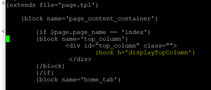

flgatormike Posted August 2, 2021 Author Share Posted August 2, 2021 (edited) As far as I can tell the carousel visibility for my theme is being controlled here. I don't know the prestashop file structure very well.. does anyone know what this "displayTopColumn" is? Edited August 2, 2021 by flgatormike (see edit history) Link to comment Share on other sites More sharing options...
SmartDataSoft Posted August 2, 2021 Share Posted August 2, 2021 Hello, the above code indicate that the slider show in displaTopColumn and here is no code related to mobile. You can check your backend any place is it disable for mobile either your pagebuilder if you Thank you Link to comment Share on other sites More sharing options...
flgatormike Posted August 2, 2021 Author Share Posted August 2, 2021 Thanks, I see the "displayTopColumn" hook, but I don't see anywhere that says to hide if mobile. Link to comment Share on other sites More sharing options...
SmartDataSoft Posted August 2, 2021 Share Posted August 2, 2021 6 hours ago, SmartDataSoft said: Please check this screen shot. Thank you Please check here Thank you Link to comment Share on other sites More sharing options...
flgatormike Posted August 2, 2021 Author Share Posted August 2, 2021 Thanks for the reply. My theme is not using the "Banner" module, it is the "Image Slider" module... but I enabled the Banner module anyway and my image slider still does not show on mobile. Link to comment Share on other sites More sharing options...
SmartDataSoft Posted August 2, 2021 Share Posted August 2, 2021 Please clear the cache from back end and also vai ftp var/caches/pro. and /dev , You can send me your site access via personal message i can check your site Thank you Link to comment Share on other sites More sharing options...

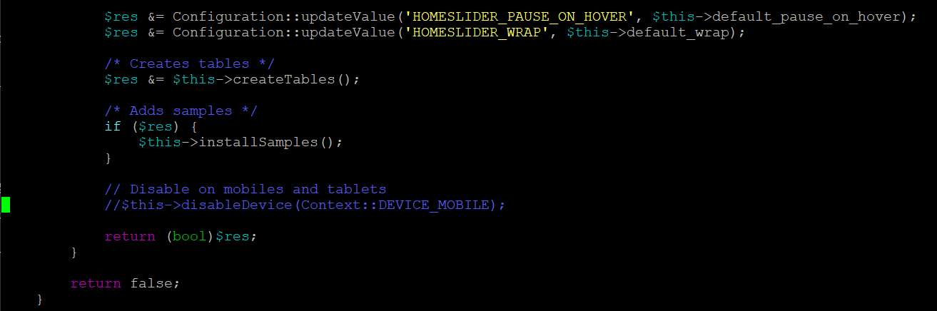

flgatormike Posted August 2, 2021 Author Share Posted August 2, 2021 I found this in /mysite/modules/ps_imageslider/ps_imageslider.php and commented it out but no luck.. that is very nice of you to offer to take a look, but I think it might have something to do with my custom theme that I purchased and probably not something that is configured in the back office. Link to comment Share on other sites More sharing options...

DorianS Posted February 24, 2023 Share Posted February 24, 2023 (edited) On 8/2/2021 at 9:39 AM, SmartDataSoft said: Please check this screen shot. Thank you This resolved my problem. I was struggling for 1h adding hooks to .tpl files, checking .js, .php etc. Nothing worked. But you helped me a lot. Thank you! Edited February 24, 2023 by DorianS (see edit history) Link to comment Share on other sites More sharing options...
